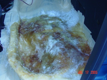

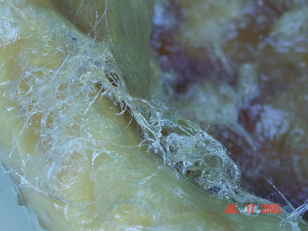

Ok day one and I got high as a kite (from the fumes) and im ready to say the he!! with it lol. Kinda like the fumes though. Take a look at the close up. How the he!! do you avoid that? Where the mat dries and its not laying on the base.. Upload

It looks like some cat threw up a hairball LMAO!

Yup, what a mess. What you see there is one gallone of resin. Its gonna take about three more gallons maybe 4. I might say fug it and make an mdf box.

Is that just one layer?
Username: Hemiboy
Post Number: 66
Registered: May-05

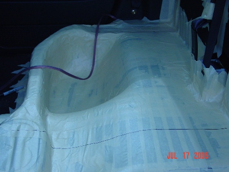

about 3 ir 4 layers. I pulled my plug and the bottome is perfect. I think Im gonna just ship it out to a professional fiber glasser. This is messy and I think I fugged it up.

told u it wasnt easy dude hehe..
the fibreglass is no where near saturated enough.. u need to slop tons of that shite on with a brush and us a small roller to get it nice and flat.. those bumps and bubbles wont work so that piece is pretty much garbage..
try it again (if u want of course) do 1 layer at first so u can test methods with it( the more layers the harder it is to work) so basicly if u have afew bubbles on the first layer then u throw the next on it gets worse and worse.. u have to have a roller to make it work .. those small painter sponge rollers work good.. just make sure its all nicely saturated.. sometimes u will have to work it in with the painbrush . like pushing the end of the brush into the mat.. good to see u tried it though .. once u get it down itl go good..btw how did u lay the mat just curious? the easiest way to do it is to cut or rip 8 inch or so squares and just apply them together all the way around.. also i hope ur buyin the material at a fibreglass shop ..few more points...make sure u go past all the points of where u want to go .. u can always cut away material after.. i hope u used some sort of mold release! otherwise its gonna be fun getting that out if its strait taped to the metal.. lastly . why didnt u do the whole bottom?

It was taped to carpet but yeah it was a biotch gettin it out lol. I ran out of resin so i couldnt saturate that last little bit. I didnt do the whole bottom because I wanted 2 seperate chambers so I was gonna do two fiber box's. I didnt have a roller DOH!!. Im gonna do a blow thru. Cut into the bed of my truck and make a box so i can go big! Screw this lil sh*t lol. Thanks bro for the info
