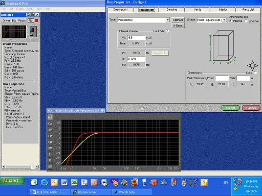

Silver Member Username: MixneffectOrangevale, Ca. USA Post Number: 218 Registered: Apr-05 | Is it the same woofer? www.kicker.com doesn't have their Thiel small parameters on their website. I need the following data: Fs: Vas: Sd: Re: Qms: Qes: |
Silver Member Username: NysteelersPost Number: 101 Registered: Aug-04 | Fs: 31.7 Vas: 71.234 liters Sd: 0.0645 Re: 7.93 (not sure bout that 1, the website sed Revc?) Qms: 10.857 Qes: 0.709 heres where i got it http://soundsgoodaudio.com/kicker/subsolobaricl7.htm and thats for the 4 ohm |
Silver Member Username: MixneffectOrangevale, Ca. USA Post Number: 219 Registered: Apr-05 | According to WinISD database for Kicker L12-4, here are the Ts parameters and the graphs: Fs:23.9 Hz Vas:141 Liters Sd:491 Cmsq Re:3.6 Qms:5.98 Qes:.51 Yellow is sealed 2.49 Cu Ft. Cutoff frequency at 40.86 Hz. (26.32" X 16.26" X 10.05") These are INTERNAL DIMMENSIONS. Red is ported 6.8 Cu Ft. Tuning frequency 19.63 Hz. Cutoff frequency at 19.75 Hz. Port is 4" x 9.437". (36.92" X 22.82" X 14.1") These are INTERNAL DIMMENSIONS. ![]() |
Silver Member Username: MixneffectOrangevale, Ca. USA Post Number: 220 Registered: Apr-05 | ok, let me run these numbers. They are different from what I used. |
Silver Member Username: MixneffectOrangevale, Ca. USA Post Number: 221 Registered: Apr-05 | Mike, Here are your graps: Yellow is sealed 4.953 Cu Ft. Cutoff frequency at 38.7 Hz. (33.1" X 20.46" X 12.64") INTERNAL DIMMENSIONS. Red is ported 7.048 Cu Ft. Tunning frequency 19.79 Hz. Cutoff frequency 18.26 Hz. (Port 4" X 8.763". (37.35" X 23.09" X 14.27") INTERNAL DIMMENSIONS. ![]() |
Silver Member Username: MixneffectOrangevale, Ca. USA Post Number: 222 Registered: Apr-05 | There is a 1.5 dB gain between 30-100 Hz. |
Silver Member Username: NysteelersPost Number: 106 Registered: Aug-04 | thanx man. this is for both subs right, cuz thats a pretty large box. and would it be common chambered then? |
Silver Member Username: MixneffectOrangevale, Ca. USA Post Number: 230 Registered: Apr-05 | No, that is for each box. Note; these alignments give you a much lower cutoff than what the manufacturer recomends. Thats why its a bigger box. I am guessing that the program is taking into accout the Vas and therefore has suggested a box that is compliant with the same pressure as the Vas compliance. |
