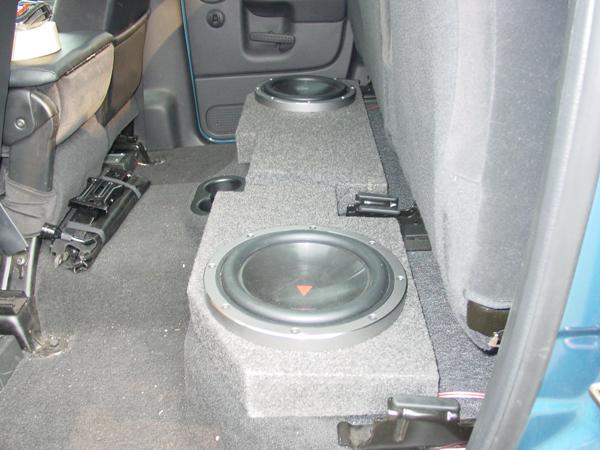

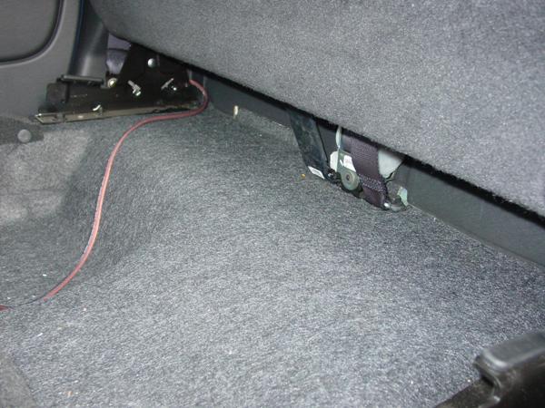

New member Username: HemiboyPost Number: 10 Registered: May-05 | OK here are some pics. Please tell me your best guess on how much ari space I can get if I glass this right. I plan to glass everything I possibly can. You can see the Two wells that my subs sit in now. The box is .68 per chamber and fits loosly in the wells. I think the manufacturer could have made it bigger. I honestly belive I can get atleast 1.5 or 1 cu ft at min. I would even go up the back of the seats if I have to. Now I cant make up my weather I should keep these subs or go with some kicker l7 10". Cause once its glassed then ITS glassed. |
Bronze Member Username: HemiboyPost Number: 11 Registered: May-05 | A few more. |

Bronze Member Username: HemiboyPost Number: 16 Registered: May-05 | OK bro thanx! Yeah my seats sit right on top of my subs so I was gonna glass a "lip" and sink the sub down a little. Maybe angle it towards the front. Is it possible to make a mold an sell my "custom box" to other dodge owners!!! Kiddin. I think this will work. In case you missed it, can you port a fiber box? and do I put fiber mat on every layer? |

Bronze Member Username: HemiboyPost Number: 19 Registered: May-05 | I would do an mdf box if you think it will be better. I have no exp in box's. My amps are 1100w max 300w rms at 4ohm and 550w at 2ohm. I have my subs wired at 2ohm. I have two of these amps one under passenger and one under drivers side i just didnt take a pic of it. One to each sub. I'm trying to find the thiel/small specs. Be back with em as soon as I find them. |

Bronze Member Username: HemiboyPost Number: 28 Registered: May-05 | Qes = 0.42 Qms = 4.15 xmax = 6 sd 0.0380 But I'll have to glass the bottom anyways. No way I can cut wood to fit in there. Mayby I'll galss the bottom and attach mdf for the top. I need to counter sink my subs cause you can see they hit my seats so mdf is probably better for that. |

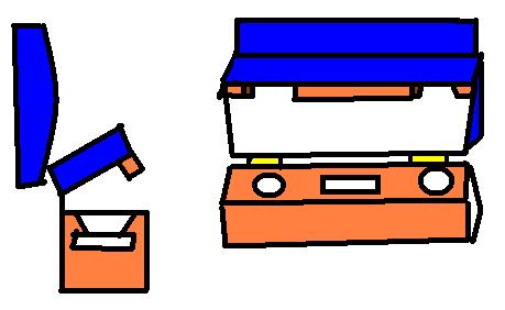

Silver Member Username: GeekbikePost Number: 267 Registered: Dec-04 | Even if you glass it, you won't gain much airspace. I can't see more than a .4 or .5cuft gain from the pics. I've seen something else done for trucks, but the place that sold them seems to be gone, so I'll try to illustrate it the best I can. It's just a quick sketch in paint, but it'll be easier to understand. Instead of having your seats mounted onto the back of the cab, they are instead mounted onto a hinged lid of the enclosure. The wooden tab things on the front of the seat will support it, and the subwoofers can breath (for lack of a better word). You can raise it all you want, until the passengers head start to hit the roof of course. I'll look around a bit more and see if I can find an actual picture of them. |

Bronze Member Username: HemiboyPost Number: 31 Registered: May-05 | Cool mod, I just ripped my seats out and the way thses new seats are I would have to raise the whole thing as one peice. The back of my seats have a fastener that attaches to the back of my cab. If i raise it I lose some security for my kids or passengers. I am sol on raising it I think. But if you look at the pic< I can cut out all of that carpet. Might have to go with 3 or 4 kicker l7 8" or something. Or buy an after market rear bench seat. Wifes gonna kill me. |
Bronze Member Username: HemiboyPost Number: 32 Registered: May-05 | The carpet doesnt follow the contours of the body, if I rip it out I am sure to gain alot more air space. The wells are squared off under the carpet. I might be able to raise my seats an inch at best. But an inch is an inch. Atleast thats whut the ole lady always tells me ;) |
Silver Member Username: RzarectorCoquitlam, Bc Canada Post Number: 420 Registered: Dec-04 | yuo shouldnt have to raise your seats for 2 10"s .. also .68 cu inches should be fine for those subs they wont perform as well in a larger enclosure.. i really think your subs are at fault here.. earlier up you said u were gonna go with alpine (my company of choice )but werent impressed with there lineup this year.. i have to agree with u .. there new hu's i think are garbage as are there new type r speakers.. but there subwoofers are great.. im running 2 12" type R's in my car right now and each of them only have .85 cu ft of airspace .. thats just lil more than your box is providing right now .. and lemme tell u they rattle my car and the sound quality is great as well.... those 2 amps would work good with 2 type r's or another sub that works well with small airspaces is a jl w6 <- awesome sq and can get loud to they would be a lil more pricey though.. 1 jl 10w6 will outperform those 2 subs.. u already have the power so its up to you.. btw i never asked is it spl u want or sq or a bit of both? |
Bronze Member Username: HemiboyPost Number: 34 Registered: May-05 | My thouts on sq when it comes to subs are prolly a little out of the norm. I dont get subs for sq lol. Thats what my mids and highs are for. My box is small but there are leaks. Mayby I should just rebuild it. Also, My subs are sounding alot better now. I think they are "breaking" in. After all this I think I'll just rip the box apart and make a new one a little bit bigger. I havent made a box before but you guys are saying its easier with mdf. I just dont see a way to get some of the contours I need. What is the absolute minimum I should build with mdf? Thanks for all the help btw! Dub6's are awsome and I've been keeping my eye on em. Waiting for them to drop just a lil bit though. Of course then I'll have to trash my amps and get a jl amp. JL mids and highs. hehe |
