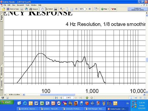

Community frequency response graph

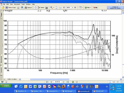

Seas frequency response graph
Notice the difference between the two. The community has a higher efficiency but does not go as low as the seas. The seas is much smoother (flatter) in the range it is designed for.
