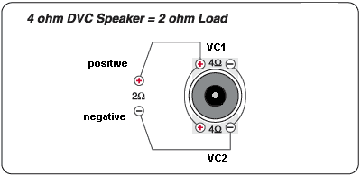

how do you hook up 4 cvr12" kicker dual voice coil sub to one 2 channel amp 850.2 kicker keeping it at 2ohms
Username: Shadylimitedx
Pgh, Pa Usa
Post Number: 240
Registered: Apr-05
is it dual 4ohms or dual 2ohms
Username: Kicker
Slave lake, Alberta Canada
Post Number: 10
Registered: Jun-05
dual 4ohms i do beleave
Username: Alias747
MN
Post Number: 316
Registered: Apr-05
your question doesn't make sense and you have to be sure what voice coil config you have or we cant help you. What exactly is it that you want to do?
Username: Sq_junkie
Anchorage, AK US
Post Number: 43
Registered: Jun-05
If they are dual 4 ohm coils then wire each sub to 2 ohms:
+to+ and -to- on each sub
then wire them like this:
sub1 series to sub2>>>(4ohms now)
sub3 series to sub4>>>(4ohms now)
then wire the:
sub1/2 combination in parallel with the sub3/4 combination.
That will give you 2 ohms at the amp.
