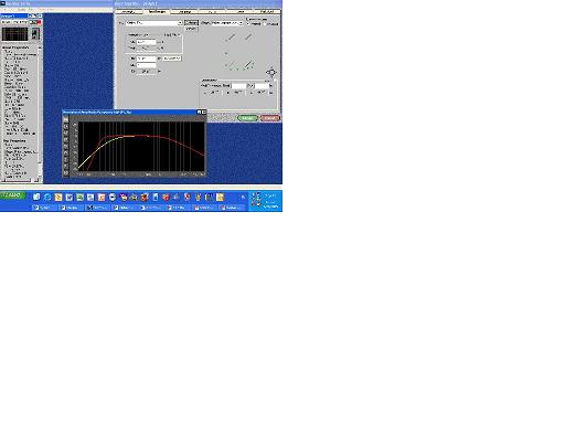

Silver Member Username: MixneffectOrangevale, Ca. USA Post Number: 148 Registered: Apr-05 | My program calculates that with the parameters given, the optimum closed box would be about 9 liters or 1/3 cu ft. This size box would yield and obnoxious peak around 110 Hz, and rolloff sharply in both dirrections. Something tells me that either the parameters are not correct or this driver is garbage. I checked Alpines website and the parameters are like you posted. I have used my program many times before and it is quite precise. I used BassBox6 Pro. I graphed out a .7 cu ft and 1 cu ft, and I got almost identical responses on the graph. Something is not right. ![]() |

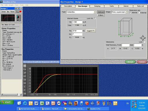

Silver Member Username: MixneffectOrangevale, Ca. USA Post Number: 149 Registered: Apr-05 | Here is the difference between a closed box and a vented box. The yellow line (if you can see it) is that of a closed box. The red line is that of a vented box. This is just to prove that vented boxes will produce extended lower bass than closed boxes. I noticed that that was your concern. You wanted more low bass out of your Alpine 12 type R's. Well there you go. Use a vented box and it will give you better results. ![]() |

Silver Member Username: MixneffectOrangevale, Ca. USA Post Number: 153 Registered: Apr-05 | Ok heres an update. I removed the large parameters and used only the small thiel parameters. I have a better response on both the closed box and vented. The vented is way better. In a closed 1/3 cu ft box you will get a cutoff of 65 Hz. In a vented 1.4 cu ft box tuned at 27 Hz you will get a cutoff of 31 Hz using a 2" port 6 5/8" long. Here are the graphs. Again, the yellow represents the closed box and the red represents the vented box. ![]() |

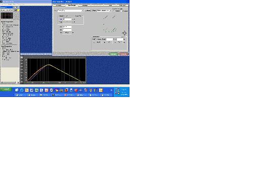

Silver Member Username: MixneffectOrangevale, Ca. USA Post Number: 156 Registered: Apr-05 | the sealed box recomendation were 1/3 cu ft. This is for optimum performance, not cut off. Theres very little difference as far as output and cutoff is concerned between the 1/3, .7, and 1 cu ft sealed box. Here are the graphs. Yellow is 1/3. Red is .7. Blue is 1. ![]() |
