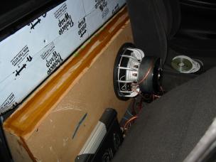

Silver Member Username: Mikechec9Chicago/atlanta Post Number: 222 Registered: May-05 | this is how someone i've spoken with inverted his sub to solve the space issue (he took out the wiring so he could carpet the box). this way, he doesn't have to provide for the displacement of his re sx 10. two things though: 1) its just one sub that sits inbetween the seats. you could mount one right above it though and still have a box thin enough to keep behind the seats. 2) to invert a w7 it will have to be mounted from inside the box. i.e., before the box is completed. just 1 idea though |
New member Username: SandviperKilleen, Texas USA Post Number: 2 Registered: Jun-05 | That's a helluva idea! I can't position it like that because I've got seat all the way across but maybe if I placed the box on the floor between and just behind the front seats with the sub firing down? Would it mess it up if I put a cover over the sub to protect it? |
Silver Member Username: Mikechec9Chicago/atlanta Post Number: 225 Registered: May-05 | not at all (just don't completely seal it when you cover it). would be interesting how you would make it work though. if you can, post some pics along the way. |
