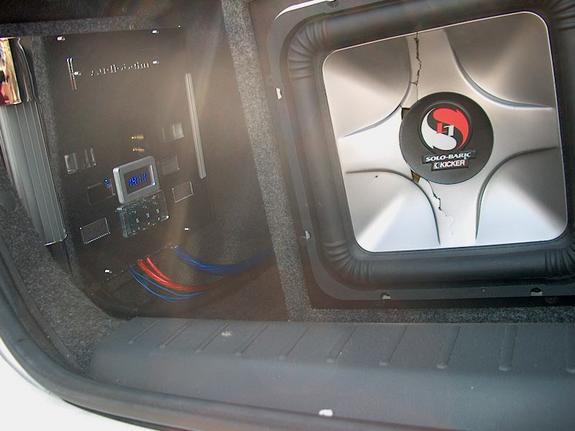

The problems attributed to the square design are cone flex, surround unraveling, excessive cone mass due to necessary bracing, which decreases it's sensitivity, lower excursion due to the limitations of the square design. But the problems aren't JUST related to the unconventional square design, it's Kickers failure to tackle other problems such as lead slap (and breakage), voice coil unraveling, an inferior motor design good for little to no useable excursion for low bass high volume performance in sealed boxes, all attributed to a POOR DRIVER DESIGN, it would be poor if it were square, round, oval, an octagon, anything really. Cone flex doesn't just increase distortion, it also promotes mechanical problems, reduced SPL (the sole purpose of these woofers) and it just plain sounds like crap compared to an equivalently build round coned woofer. Ask somebody who sells or installs L7s, I'm telling you from experience with them. They have one of the highest failure rates of any subwoofer.
Inherently flawed by the design. Even the caring Chinese personnel that produced this sub couldn't help it out.
