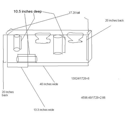

Gold Member Username: SubfanaticWalton, Ky Post Number: 3819 Registered: Dec-04 | is this diagram right???? but man thats harsh about smoking lol i tried soooo hard to get these measurements easy, is there an easier way, and this is internally not externally ![]() |
Gold Member Username: InsearchofbassPost Number: 2312 Registered: Jun-04 | looks like it could be right can you post the link here with my results i cant remember where it was |

Gold Member Username: InsearchofbassPost Number: 2317 Registered: Jun-04 | i cant understand the draft....its prob not you its prob me....can you explain the height width and depth of the box to me |
Gold Member Username: SubfanaticWalton, Ky Post Number: 3836 Registered: Dec-04 | its 17.28 tall for the whole thing. k. THe main chamber is 20 inches deep and 40 inches wide, this is all internally by the way, the second smaller chamber is 17.28 tall, 20 back and 13.3 inches wide, internally of course, and the first chamber is 8 cubic feet and the second is 2.66, the link to the website showing the abc box said the main chamber has to be at least twice the sizr of the second, so is that right 2.66 and 8 AFTER DISPLACEMENT???? or what, cause i dont know the displacement of the TI, you prolly do lol, am i right??? |
Gold Member Username: InsearchofbassPost Number: 2318 Registered: Jun-04 | your first chamber came out to 8.00 cf you want 5.33 cf. second chamber is 2.66 cf which is correct |
Gold Member Username: InsearchofbassPost Number: 2319 Registered: Jun-04 | finding the displacement of the subs is important and the displacement of the ports |
Gold Member Username: InsearchofbassPost Number: 2320 Registered: Jun-04 | 10.5 inch long ports three of them |
Gold Member Username: InsearchofbassPost Number: 2321 Registered: Jun-04 | needs to be a 66.666 percent 1st chamber after displacements and 33.333 percent 2nd chamber after displacements |
Gold Member Username: InsearchofbassPost Number: 2322 Registered: Jun-04 | so if the subs and port displacements in the first chamber were .60 then you would add .60 to the 5.33 cf target for the 1st chamber and do the same for the second chamber (ex. if the displacements for the second chamber were .10 then you would add .10 to 2.66 which is 2.76 cf) |
