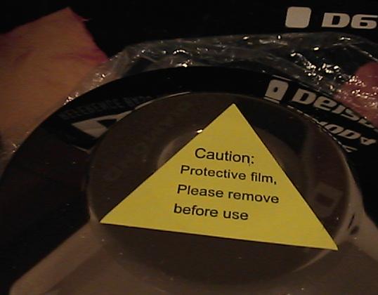

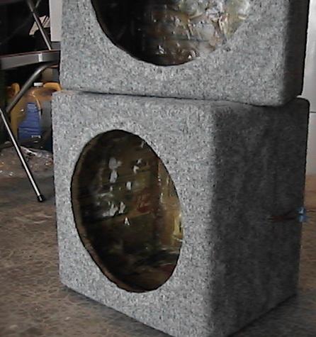

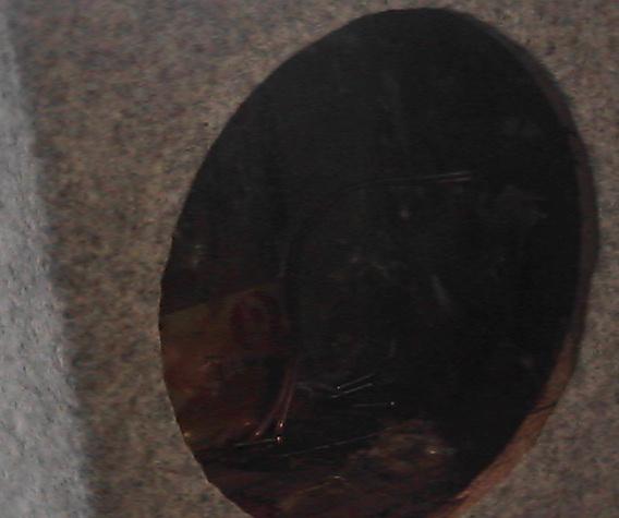

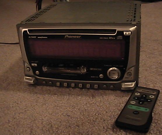

Bronze Member Username: Xtant1001Post Number: 64 Registered: Apr-05 | I am selling 2 NEW 12inch Diamond D6 Subs. I am asking $325.00 plus shipping Per Subs. These are the new line of Subwoofers from Diamond. These Subs are still in the factory box and never been Used at all. Also I still have my Xtant 1001 that Im also selling and asking $600.00 plus shipping for the Xtant 1001. The Xtant I just got back from factory also so it is in good condition. The Pioneer Double Din I am asking $100.00 plus shipping for it. 2 carpeted Enclosure Fiberglass Box which weighs less then 5 pounds asking $125.00 each plus shipping. Email unan0@hotmail.com or call (425) 985-5415 if interested. I can take Paypal unan0@hotmail.com but please add 3% for the fee, or contact me for other arrangements. Thank you for looking. |
