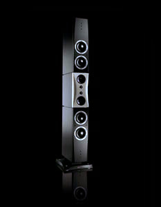

Bronze Member Username: MixneffectOrangevale, Ca. USA Post Number: 11 Registered: Apr-05 | Take for instance the Dynaudio Temptation or the Dynaudio Master. They each have multiple drivers being used for the same function, and no audible problems. ![]() |
Silver Member Username: FishyTamarac Ft.Laud, FL USA Post Number: 888 Registered: Sep-04 | 2 10's and 2 12's playing at the same frequencies has the potential to sound like complete @$$, but hey, they're Audiobahns. May not even notice a difference. -Fishy |
Bronze Member Username: MixneffectOrangevale, Ca. USA Post Number: 16 Registered: Apr-05 | Ha Ha Ha Are you kidin me??????? When you have a 3 way with a crossover; Do you think that the woofer is going to stop at the crossover point and play no further higher frequencies? What about the mid is it going to not play any frequency below or about its bandpass crossover? Get my point? Just because one driver is playing at a different SPL level compared to the other one, doesn't mean that they will sound bad together. Also just because on will hit harder at 60 Hz and the other at 50 Hz, doesn't mean they will sound bad together. Test it for yourself; Listen to a duet or a Choir. Some people have higher efficiency vocal chords than the person singing next to them. While others may have a different tone. As a matter of fact that's what makes duets so beautiful. The contrast between the two. |
Silver Member Username: FishyTamarac Ft.Laud, FL USA Post Number: 893 Registered: Sep-04 | No speaker in existence can reproduce dynamics realistically; but we try to reproduce it as closely as we possibly can. Transparency is largely a product of the ability of the cone to react speedily to the signal -- so speed is of great importance. Cohesiveness is what one gets when one uses a single driver instead of multiple drivers -- there is a "wholeness" to the reproduction that is very difficult to put into words. This cohesiveness is both the result of not having multiple radiating sources with all the inherent wave interference problems, and not having multiple drivers with unmatched tonalities. Matching the tonality of any 2 or 3 or 4 drivers of different sizes is quite an impossible task, it is like having you and me, both of us, sing middle C, and hoping that we sound identical -- and we will not. Portrayal of detail is again, I believe, a consequence of speed and transparency, and this is essential for filling in the finer nuances of a performance. from here: http://www.dagogo.com/RethmInterview.html The "perfect" loudspeaker would utilize only one driver, but in the real world and especially in the mobile audio enviroment this simply isn't practical so we have to put up with the limitations of using more than one driver. The whole purpose of a crossover is to separate, yet meld unlike drivers with different phase and tonality characteristics. Adding unlike drivers playing at like frequencies only compounds the situation as anyone who's spent hours attempting to find the "best" midbass, mid, and tweeter locations to can attest. Placement of a single full range factory speaker is quite a simple endeavor in comparison, but with multi driver sets imaging, tonal, phase and directivity issues raise their ugly heads in the neighborhood of the exact crossover frequencies you describe. The goal of most "great" acoustic transducer systems is to reproduce the original recording as faithfully as possible. Anything that alters or changes this, like an added set of vocal chords, may sound "allright", but will reduce sonic accuracy and is therefore something the typical audiophile would want to avoid. No, I have to admit this may not be as critical with a subwoofer application and many here just want it loud, but a few of us actually enjoy to the intricacies of a particularly good recording played at moderate levels. Go ahead dude. Drop thsose extra 12's in. If all you want is more volume it'll probably suit your needs just fine. -Fishy |
