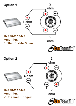

Bronze Member Username: NapalmzMIDWEST Post Number: 66 Registered: Oct-04 | you can also keep your rf amp and get another amp of your choice and run 1 sub to each amp at 2ohm and you will be fine... |
Bronze Member Username: NapalmzMIDWEST Post Number: 67 Registered: Oct-04 | woops my fault not 2ohm it would have to be 1 or 4ohms..heres an example...![]() |
