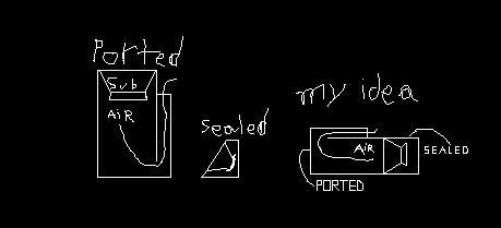

I had an idea today on making a duo enclosure by taking a sealed enclosure and a band pass and converging it together and srewing the speaker dead in the middle. what do u think? would it have the hard hitting of the sealed plus the higher sound of the bandpass? or something like that.

ok not the sealed but other box looks like this
_________
!OOOOOO!
!OOOOOO!O!
!OOOOOO!O!
!OOOOOO!O!
!OOOOOOO!
OO = free air
the sub at the top and the air goes down and up out the side. this is not bandpass? or wait its ported right. Can I use paint to show u a accurate diagram of my box plan?

got it finally -- well?

you basically drew a bandpass box dude...

no because if it was a bandpass the sub would face away from the hole.

your drawing is fo a 4th order bandpass enclosure.
that's the type you see at best buy made by q-logic and sold for about $50.
sealed behind the sub, vented in front, or vice versa.

What you did was inversely mounted the sub in a 4th order bandpass. Like if you took a sealed enclosure and mounted the sub magnet out.
