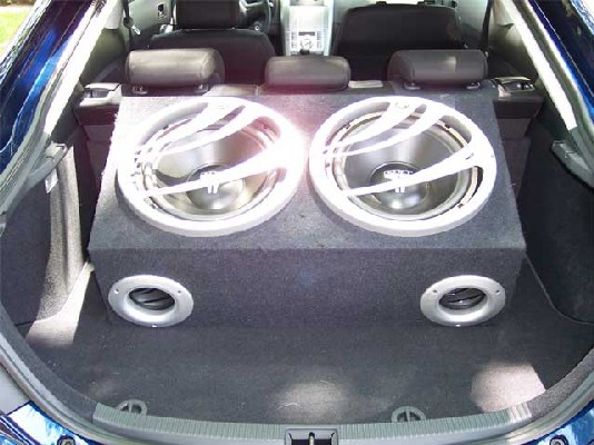

honestly dude, id love to use 12s. My cousin had 12w7s, i have 2 friends with 12w3s, one with 12w6s and my other cousin had some older 12` infinity kapps. All sound really good, but i just dont think itll fit. If you have some time check this trunk space out http://www.cardomain.com/memberpage/638714/3
I read that theres about 12.8c Cu Ft
heres some other setups.. i guess it can give you some sorta idea about the space i have to work with
http://img124.exs.cx/my.php?loc=img124&image=setup5iv.jpg (theres a 12 on the side, but in white is the plan i have for my sub.. 2 seperate enclosures on each side sort of molded into the sides)
another dudes setup: http://img116.exs.cx/my.php?loc=img116&image=tc1ll.jpg
If you have any better ideas please share

you could easily fit 12" subs in that car if ya angled the box so they fired upward toward the front ceiling of the car, or toward the rear glass.. but that'd eat up most if not all of your hatchback area. It should be a great little car when it's done.
That scion is cute.

glass do you think theres any pre made custom boxes that would work well for my setup. Thats just in case that the custom setup is too expensive
Username: Glasswolf
NorthWest, Michigan USA
Post Number: 6452
Registered: Dec-03
for a civic?
lots and lots of boxes
Username: Udai
Post Number: 23
Registered: Dec-04
na, for the TC (keeping in mind the space i have)
And something to spec of the 2 IDQ 10s. I wanted to keep them in seperate boxes at each end of the trunk.
Username: Glasswolf
Post Number: 6473
Registered: Dec-03
best bet may just be building or having built for you, a custom box..
