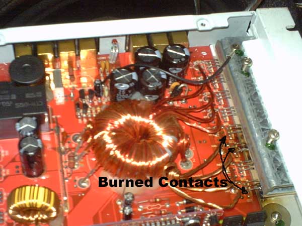

New member Username: TripstarPost Number: 2 Registered: 01-2004 | Here's a shot of the damage. ![]() |
New member Username: TripstarPost Number: 3 Registered: 01-2004 | closer examination shows 4 fried semis. I can replace them, but I wonder if the same thing will happen. Now I'm starting to think the bottom of the case must have gotten bumped and caused the mounting leg to contact the semis, shorting them out. But that's just my theory of the moment ![]() |

New member Username: TripstarPost Number: 4 Registered: 01-2004 | Thanks. I was halway through the repair when I got your post. But it was still decent of you to answer. And I also got an answer from tech support at Crossfire, so they are good guys too. Anyway, Radio Shack, of all places, carries the replacement mosfets for $2 a piece. They went in easier than the old ones came out, but everything is back together and working fine now. Thanks again. |
