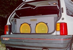

the Infinity Perfect isn't 6" Xmech.. lol My RE triple X 12" subs have a full 3" peak to peak and they're far greater Xmech than those Perfects.. just to get that clear.
now for grilles, go to crutchfield, or partsexpress.com and get a set of waffle style frilles.
they are convex in shape so they arch away from the subs to add space.
If more is needed, you can cut a spacer ring from MDF to go between the grilles and subs, too.
those are your best protection against a puppy. far better than the fancy crap they make for subs like audiobahn or kicker that look pretty but don't really keep paws out of the cone area.
they aren't the prettiest things, but I used them in my car for years and never so much as dented one.
example:

there

i posted this same topic a few days ago but got no responce so please dont think im butting into this thread. i have 2 12" VMAXs with an xmax of .8" would those same waffle type grills work for my subs? i dont care about looks really.. just as long as they get the job done. thanks

Yeah, you shouldn't have a problem at all. Most grilles can provide about an inch clearance or more.
