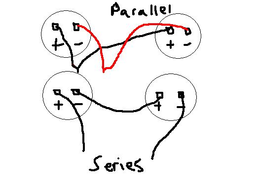

Silver Member Username: BoopersLima, Ohio United states Post Number: 200 Registered: Jul-04 | how would you wire a sub both ways, I don't think you can. if you have the jumpers for parallel and series all hooked up at once that wouldn't make any sense. |
Gold Member Username: Jonathan_fGA USA Post Number: 2470 Registered: May-04 | What you would do is as this picture shows: and each set of voice coils of the sub has it's own terminal. |
Silver Member Username: BoopersLima, Ohio United states Post Number: 201 Registered: Jul-04 | ah, that's a lot of wiring, but good idea, so I would need 2 sets of terminal cups is all, where can I get good ones, something that would keep the thickness of the 12 awg speaker wire advantage I have? |
Gold Member Username: Jonathan_fGA USA Post Number: 2472 Registered: May-04 | These are really good. http://www.madisound.com/benniccups.html |
