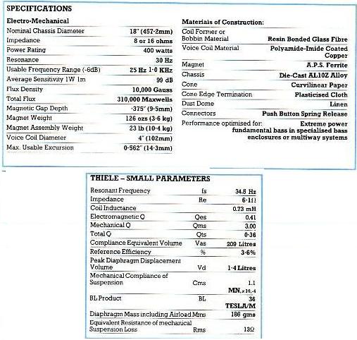

Silver Member Username: MaxkillaMalta Post Number: 119 Registered: Jan-04 | These are some more information about the sub |

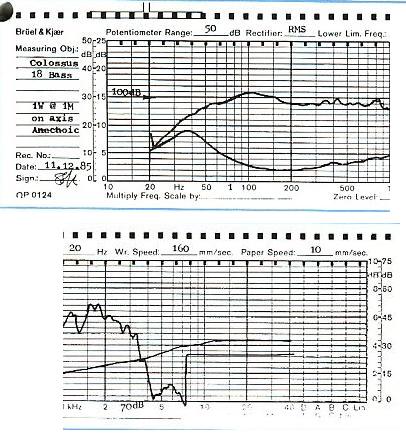

Silver Member Username: MaxkillaMalta Post Number: 124 Registered: Jan-04 | Anybody knows how to read these type of tables ? Any pros out there ? What do these tables tell you about the performance of this sub ??? is it good or its bull**** ? |
Silver Member Username: FishyTamarac, FL USA Post Number: 562 Registered: Sep-04 | I dunno. It has a higher resonant frequency than a 10w3 so I'm not to sure how low its going to play. I wouldn't tune it below its fs(30 Hz) regardless. Being 8 ohms is also going to be a problem as mentioned above. Your going to need a BIG amp capable of producing 400 watts @ 4 ohm stereo(8 ohm bridged) to get 400 watts to the thing. For example a JBL BP1200.1 only produces 300 watts at 8 ohms. To me it reminds me of the drivers you see hanging from the ceiling of an auditorium. 18" means better efficiency to break concert goers' eardrums, not low bass in this case I think. Download winISD and plug in those numbers. You may need a HUGE enclosure to get the kind of low end response you're lookin for. -Fishy |
Silver Member Username: FishyTamarac, FL USA Post Number: 563 Registered: Sep-04 | [edit] Take that back. It has a fs of 34.5 Hz. Don't tune below that. |
Silver Member Username: FishyTamarac, FL USA Post Number: 564 Registered: Sep-04 | Nevermind I plugged em in for you. This is what the gain curve(s) look like. http://home.comcast.net/~guppyrig/wsb/media/322068/site1060.JPG The green plot is the "optimal" alignment that winISD recommends(5 ft^3 @ 38.75 Hz), the light blue is the 10w3's I have in my Explorer, and the yellow is me tryin to make that 18 sound "better"(5 ft^3 @ 42 Hz). As you can see that monster doesn't play very low, relatively at least. You can get a lil better low end by making the box bigger(like 8 ft^3), but I figured, well ......... Honda Civic. This doesn't mean you can't make that thing sound good. You're gonna get a bit more low end response from cabin gain than what's indicated in those plots, just not that uber low, I can't breath, kinda stuff. But hey. Its an 18! Thats impressive in and of itself. -Fishy [note] you can always "hide" a couple 10w3's somewhere under that box. Hell you could even convert the Colossus to a "drone cone" and use it as a passive radiator. Most peeps wouldn't know the difference. ;) |

Silver Member Username: FishyTamarac, FL USA Post Number: 581 Registered: Sep-04 | 2 ft^3 is awful small for an 18. With that setup you'd basically have a midbass driver from hell. Your lookin at about a 50Hz down 3dB point. Not too sporty for a SUBwoofer, well a ported one at least. I'd look into other options. -Fishy |
