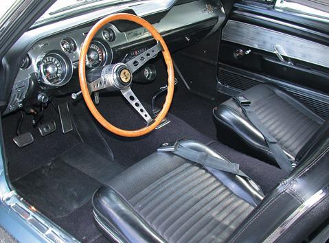

Take a look at this picture (no, it's not my car)
Imagine the possibilities. If you're wondering, those kick panels have enough depth behind them to actually seal a midbass driver (with a good amt. of volume at that), so midbass can be great, especially w/ a little polyfill, it takes just a minor amt. of cutting. And, look at the smooth dash, unobstructed dash. No console to interfere, and no dash in the way. And with the size of the kicks, you can even fit 3 way components in the kicks(ones with an 8" midbass driver, yay!), which is really good stuff. That's what I'm considering doing. With that car, you can put two 12" subs AP between the cabin and trunk (if I remember correctly, I know there is enough for 10s). Cabin is smooth, rear seat never gets in the way, it can also be folded down or removed (you could flush mount amps in the floor, and use the trunk for storage as usual). Fastback performs similarly to a hatchback as far as SPL.
