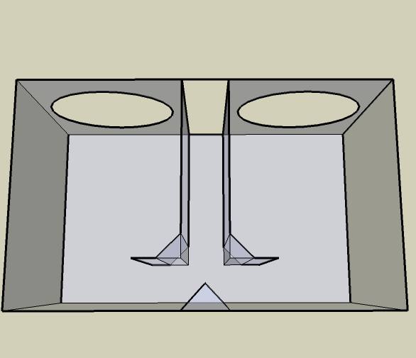

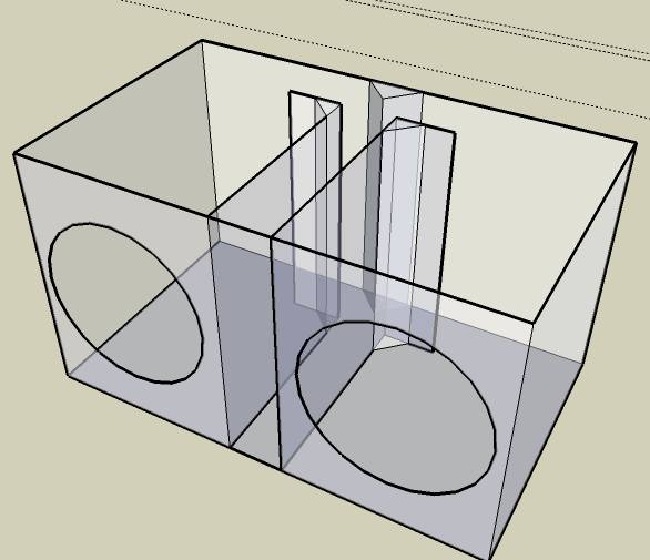

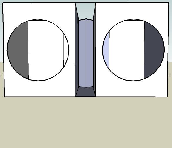

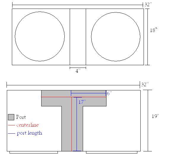

This is a rough draw up of what the box is gonna be like, and i'll take a second to explain the visual so it doesnt look so confusing.
The image on top is a picture of the front view and the corresponding measurements. The port is 4" x 18" and is in the exact center of the box. The box measurements are 32" x 18" x 19" with a total volume of 5 cubic feet.
The bottom picture is a view from the top, which shows the port calculations for a 35 hz tuning. With a 4" x 18" port area the length needed was 23 inches. To accomodate a 23" port in my box i needed to angle it. It came out to 17 inches deep and 6 inches to both sides from the center to get 23" .
Now for the 3d model pictures.
(from the top)
The front.
and a skewed view
This is the final design of my box, ive begun cutting out the peices from 3/4" MDF but I dont have a lot of time during the week or a lot of the tools to do it quick so I wont get to work on it until Friday. I'll take some pictures during the process and post them up this weekend to see what you think.

Looks like a nice box. Cant wait to see it built.
SQ = SoundSplinter RL-s
Post Number: 14025
gotta love the detailed descriptions. mad props big harv.
also that box looks like it is going to pound. hope you have as much wood working skills as sketchup skills. i'm sure you do.
Username: Schinner
Post Number: 64
dang big harv... awesome pics and description
