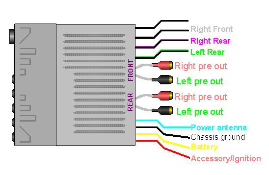

Bronze Member Username: Randy420Post Number: 60 Registered: Dec-03 | i just bought a wiring harness for my 97 ford explorer...now i got the two ends and my other end for the kenwood deck.. does anyone know where their is a dirgram so i could connect the two...the deck part says p.con, rear L, rear R, front L, front R, and a black,red,yellow wire left over |
Gold Member Username: IlluminatorPost Number: 1221 Registered: Apr-05 | ![]() Blue/white wire=remote turn on wire. It's missing from this diagram. |
