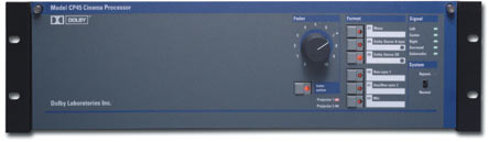

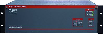

The basics of the Dolby Surround-EX "SA-10" comes from the Dolby CP-45 which is an affordable Dolby Stereo processor for some cinema chains that can't afford the CP-500 or the CP-650, the CP-45 like its earlier CP-50 which came around in the mid 1970's is similar, thou fewer improvements have been made to the Dolby Stereo matrix over the years, and with A and SR type NR noise reduction, making films sound better.

Hear is a view of the professional Dolby CP-50, CP-45 and the SA-10.Upload
