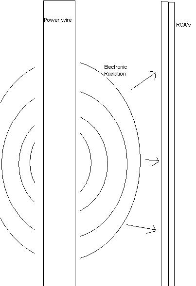

well it wouldn't be the remote wire causeing the interference... it would be the power wire... The signal that runs through a wire is just electricity, and when it's running through the power wire, it leaks out like radiation. If your rca's are close to it, the radiation interferes with the electric signal in the RCA's.

I already ran the power wire through the same side as my RCAs and I dont' really fell ike changing it.. Is there anything else I can do? If I wrap the RCA wires with electric tape will that help the problem?
