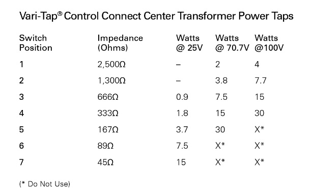

I have an apc-30t speaker (weird speaker, my main concern), and an old general electric cb radio which is rather small, so easy to tuck away.
The speaker i have has this adjustable transformer thing, and says its rated for 30 watts.
I would plan to hook it up as such:
CB -> car amp (30 watt rms??) -> apc-30t speaker.
Here is an image from the datasheet of the speaker.
My question is: is this the best way to do this, and what should I look for when buying a used amp so I can get the most out of my speaker? Thanks.
