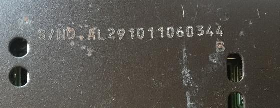

Username: Wenbinsun
Registered: Oct-20
Please give ME code:Mercedes-Benz MF2910
A17082030836
S/NO:AL291011060344
thank you

Username: Wenbinsun
Hi, try code 61696

Username: Wenbinsun
Registered: Oct-20
I'm sorry ,the code is wrong
you look at the picture again
thank you

Username: Regrooster
Post Number: 13089
Registered: Aug-08
61696 has been checked and is the correct code
Your radio must have recoded to a different number in the past
Username: Wenbinsun
Registered: Oct-20
Is my input method is not right?
Be sure to enter it with the on on the right,right?
is there any other way to type?
I'm trying to figure out,look at the chip without any weld marks,strange..
Post Number: 13091
Registered: Aug-08
Code Entry as Follows:
Switch Radio On - Display Shows
" CODE " With " C " Flashing
Rotate RH Tuning Knob to Select 1st Digit
Press RH Tuning Knob to Enter
Rotate RH Tuning Knob to Select 2nd Digit
Rotate RH Tuning Knob to Select 3rd Digit
Rotate RH Tuning Knob to Select 4th Digit
Rotate RH Tuning Knob to Select 5th Digit
If the correct code number is now shown
Press And Hold RH Tuning Knob To Enter
Username: Wenbinsun
Registered: Oct-20
I've tride everything .the input's not decoded properly.
Now I would like to be able to adjust the way out of the hardware
thank you very much!
