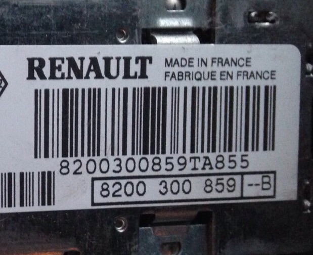

hi guys. I have a Renault grand scenic and had to have a new battery Saturday. Now i have no radio. It's driving me mad driving in silence. Can anyone help? The last 4 digits in the code under the barcode are A855
Thank you and let me know if you need any other details.

Hi! Thanks for the speedy response. It's not worked I'm afraid. I'm typing it in, do I need to do anything after that, press any additional buttons? It's just beeping that it's not correct at the moment.

It worked!! Didn't realise I had to hold 6 down to activate it. You have saved my sanity. Thank you!!!!!

Code Entry as Follows:
Switch Radio On - Display Shows
" 0000 "
Rotate " Thumbwheel " For Correct Digit
Press " ¬ " On The Stalk Control To Enter
If the correct code number is now shown
Press And Hold " ¬ " Until A Beep Is Heard
or
" CODE " Then " 0000 "
Press preset " 1 " repeatedly for 1st Digit
Press preset " 2 " repeatedly for 2nd Digit
Press preset " 3 " repeatedly for 3rd Digit
Press preset " 4 " repeatedly for 4th Digit
Press and hold preset " 6 " To Enter
