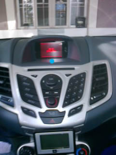

Silver Member Username: ChofilenaIloilo, Iloilo Philippines Post Number: 160 Registered: Oct-11 | Thanks! I was hoping that. So its free air and I can mount it on top of the dashboard. What do you think of this location (blue dot on the dash)? The driver is shielded, does that mean it wont harm my display unit and my HU or it will? Speaker will be facing upwards and towards the windshield. Please advice, before I do something really stupid to my car. Thanks Glasswolf. ![]() |
Platinum Member Username: GlasswolfColumbia, South Carolina America Post Number: 14728 Registered: Dec-03 | when you start reflecting speakers off of other surfaces, you will begin to encounter problems with phase shift and signal path length disparities. You'd probably be better off putting a center channel lower in the dash and just aiming it upward a bit toward the head position of the listener(s) shielded speakers shield the magnet of the driver so it won't affect things with it's magnetic field, such as a CRT. Not really a concern with LCD displays as they do not contain magnetically controlled electron guns like a CRT does. That is really an ugly, transofrmer looking dashboard that car has. I think a good spot for the center might be that "mouth" looking thing in the center of the console. If that's not important, replace it with an ABS panel and mount a speaker in it. |
