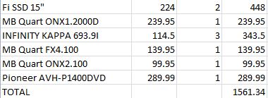

Gold Member Username: Joe1234Post Number: 1414 Registered: May-09 | Ok this is what I would think fit your application, and most of all your budget, will be definitely as loud as needed and also provide more than enough sound quality for a club like environment, by no means is final though: Subs: (Look for the 15"): https://ssl.perfora.net/www.ficaraudio.com/sess/utn;jsessionid=154f32b80525918/ shopdata/0050_Speakers/0040_SSD/product_overview.shopscript Subs amp: http://www.sonicelectronix.com/item_44471_MB-Quart-ONX1.2000D.html Speakers (2-3 sets): http://www.ebay.com/itm/INFINITY-KAPPA-693-9I-IN-CAR-AUDIO-STEREO-6X9-6-X9-330W-3-WAY-SPEAKERS-SET-PAIR-/360453634627?pt=Car_Speakers&hash=item53ecb5fa43&vxp=mtr Amps for speakers: http://www.sonicelectronix.com/item_33005_MB-Quart-FX4.100.html http://www.sonicelectronix.com/item_44472_MB-Quart-ONX2.100.html A/V Deck: http://www.sonicelectronix.com/item_42780_Pioneer-AVH-P1400DVD.html The enclosure for the subs should be 4.5-5 cubic feet tuned to 33Hz center port. On the dims you provided here is a sketch of possible speaker placement, definitely not unique or final, dismiss the appearance of things please: From a similar projects I have seen equipment should not be visible or accessible. The final electrical system specs will depend on all of the equipment you will be fitting, including non audio like a cooler, lighning etc.. |
New member Username: ExcursionsPost Number: 5 Registered: Apr-12 | Okay, So first I want to say thank you for all the help so far. I have purchased all of the equipment and it was right about $1500. (so thank you). My only problem now...is that the Pioneer 1400dvd HU is a bit more difficult than I thought it would be, specifically in two areas. The first is the parking brake wire...This is a Limo bus, so the head Unit is not being watched by the drive, it is for the passengers behind the driver's seat. If there a way to make the dvd play while in motion. The second issue is that the limo bus does not have an ACC position on the ignition, so what do i do with that wire in order to make it work? Thanks again for any insight! |
