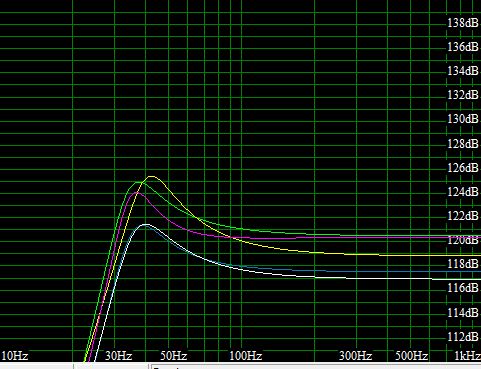

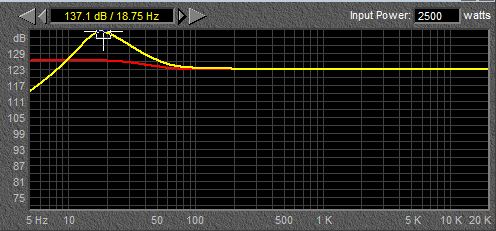

The online version of WinISD will not put in proper light the output among subs, the gain plots show the relative gain on the frequency range for a specific sub and specific box (so power and sensitivity dismissed) so for example here are the gains for the Sp4,Q and BL, green ,yellow, red respectively:
Enclosure is 4cu.ft.@33Hz:

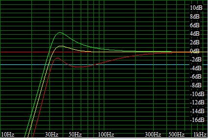

Here is a SPL plot is the same as before but on rated power (2500,1500,1500) and sensitivity accounted for:
To notice the BL doesn't look as bad against the Q as a relative gain plot may suggest, also the Q is only 2 dB below the SP4.
Also can be seen that the BL is not in it's ideal enviroment underperforming in the low end, showing the effects of Hoffman's law.
Without a car transfer function also is hard to say if a particular response will be beneficial or not in a particular car, I understand that aleros main resonant frequency is in the lower 40s so for a SPL setup one would seek to hit that frequency and for SQ one would try to avoid it when tuning the box, this is when a parametric equalizer comes into play, one can place a notch of specific Q at that frequency to try to recover linear response on a given range.

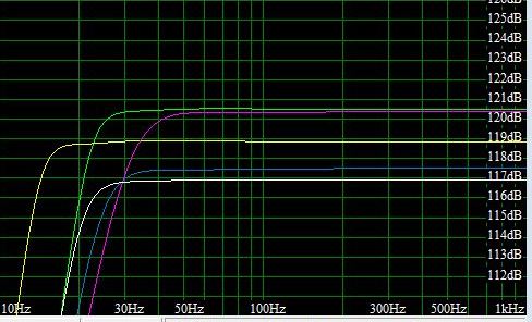

So here are the results:
All subs 4 cu.ft@33Hz all subs on rated power.
SP4 - Green
RE XXX - Yellow
LMS Ultra - Violet
LMS-R - White
Axis - Blue
The RE will probably hit your main resonant frequency, the XXXs peak high on the mfr recommended enclosure and drops fast after that, only way to help it is tune lower.
As far as output goes it seems the Axis and LMS-R are losers and the Ultra, not sure if the 15" is still around.
Another fun thing to watch is the same drivers on optimized enclosures for linear performance:

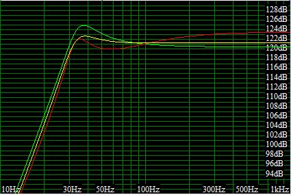

The Sp4 18" ported vs sealed. Average car cabin gain accounted for:
Default alignment (other cabin effects and coil inductance effect not accounted for), this is just for you to look how both are expected to perform inside a car.
With sealed if you are not reaching a near Xmax excursion at rated power then you may grow the net volume until you do. that will give you the max output (until it starts to get hot inside anyway).
To me the downside of ported is when a design is not made to control group delay,
