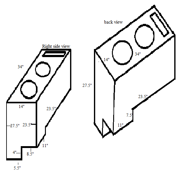

Silver Member Username: E3_overkillPost Number: 105 Registered: Jul-11 | well its not to easy on this on, cause the floor in the back isn't totally flat it has two step ups. if that makes any sense. ill have to draw you a picture or something and show you. but as far as the speakers i don't want one with crossovers cause i have no where to mount them unfortunately. So i need speakers that have good mid bass but good highs. That can be ran of an amp without crossovers. sorry for not stating that earlier that's my bad. Well as far as the sub it will be the sundown audio's i got before if you remember. hahaha my benz is having to many problems so im getting rid of it most likely ; ( and i got a new saz 1500D. |
Silver Member Username: E3_overkillPost Number: 106 Registered: Jul-11 | well its not to easy on this on, cause the floor in the back isn't totally flat it has two step ups. if that makes any sense. ill have to draw you a picture or something and show you. but as far as the speakers i don't want one with crossovers cause i have no where to mount them unfortunately. So i need speakers that have good mid bass but good highs. That can be ran of an amp without crossovers. sorry for not stating that earlier that's my bad. Well as far as the sub it will be the sundown audio's i got before if you remember. hahaha my benz is having to many problems so im getting rid of it most likely ; ( and i got a new saz 1500D. |
Gold Member Username: Joe1234Post Number: 1218 Registered: May-09 | Ok E3, doing a box that accounts for uneven surfaces would be not the way to go, give some dims that can be used. you will need 1.75-2 cuft net for those. I will look into the speakers, something with integrated crossovers, look into the HAT IMAGINES or the Focal IS165 see if you like them, no cross networks. You are selling the car to fit better audio.. shows love if you do it! |
Silver Member Username: E3_overkillPost Number: 107 Registered: Jul-11 | hahaha your saying you might be interested in my car haha. but yeah theirs going to have to be and indent on the box cause their will be no way around it. cause the truck has like a plastic cover in the back extended cap part that covers the jack. so ill show what i mean and you can tell me what you think. just probably build like a step up then have the box start. so just let me know what you think. just a quick paint thing i made up haha. but yeah ill definitely look at those speakers. and im giving the view as if you were sitting in the drivers seat and you turnt around and were looking at the box. If that makes sense. hahahah ![]() |
Gold Member Username: Joe1234Post Number: 1222 Registered: May-09 | The box is small, you need 3.5-4 cubic feet net (Vb) for the sa-12 unless you want to go for a high tune SPL, in which case a 3.2 cubic feet would be in order, currently you are below 3. |

Silver Member Username: E3_overkillPost Number: 109 Registered: Jul-11 | so what if i just squared the design at the top? Height= 23.5", width 34", and depth 14" inch . With that box squared off it should be over 3.2 net cuft? right? and as far as that site you showed me selling the refurbished sundown amps. Do you think the company and the refurbished amps are good ? I think the site was that "db.r.com" or something |
Gold Member Username: Joe1234Post Number: 1225 Registered: May-09 | With 23.5" x 34" x 14" as maximum dims this can work out: Enclosure Specifications: Fb = 37.92 Hz Vb = 3.494 ft^3 Subwoofer Mounting = Flush Mounted External Height = 23.5 in External Width = 29 in External Depth = 14 in Port Width = 3 1/2 in Cut List: * All Dimensions in Inches. * Wood Thickness is 3/4 for all Parts. External Enclosure Parts: 2 x Top & Bottom (3 parts) = 29 x 14 Left & Right Sides = 12 1/2 x 21 1/4 Front & Back = 29 x 21 1/4 L Port Internal Assembly Parts: Front to Back = 14 3/4 x 12 1/2 Yes you can trust db-r, here's the site: http://www.db-r.com/sell/store/ |

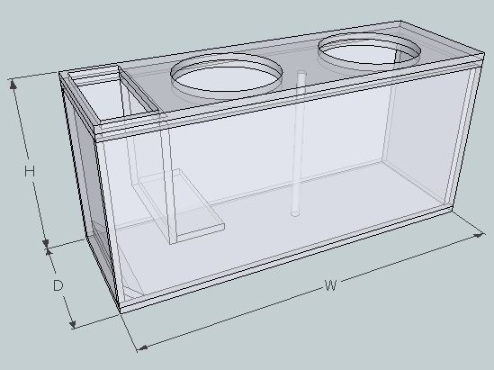

Silver Member Username: E3_overkillPost Number: 116 Registered: Jul-11 | Hey Joe i was wondering if you could do a cut list for those dimension? Height= 16in. Depth= 14in. Width= 41.5 in. And possibly do that 3D drawing? I would really appreciate it. Thanks Joe |
Gold Member Username: Joe1234Post Number: 1363 Registered: May-09 | Ok E3, here are the cut sheet list and a generic sketchup: Enclosure Specifications: Fb = 38 Hz Vb = 3.207 ft^3 External Height = 16 in External Width = 41.5 in External Depth = 14 in Port Width = 3 1/2 in Cut Sheet List: * All Dimensions in Inches. * Wood Thickness is 3/4 for all Parts. External Enclosure Parts: 2 x Top & Bottom (3 parts) = 41 1/2 x 14 Left & Right Sides = 12 1/2 x 13 3/4 Front & Back = 41 1/2 x 13 3/4 L Port Internal Assembly Parts: Top to Bottom = 10 1/4 x 12 1/2 Extension = 2 1/4 x 12 1/2 Although technically a single 6" aero would not be enough port area I have seen it used frecuently with sa-12s you may want to look into it. |
Silver Member Username: E3_overkillPost Number: 117 Registered: Jul-11 | What would an aero port accomplish me rather then a normal port? I've never really look much into aero ports. And thanks for the 3D drawing helps alot. |
Gold Member Username: Joe1234Post Number: 1366 Registered: May-09 | The advantage would be a little smaller box. |
