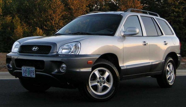

New member Username: InsaniakAmerican Fork, Utah United States Post Number: 1 Registered: Jan-12 | Ok so my girlfriend recently acquired a 2004 Hyundai Santa Fe, and the speakers got blown pretty quick (we like to sing really loud) I know absolutely nothing about tweaking/changing vehicle audio systems, and I need to know everything I have to do to put in new speakers, and she also wants a sub and a new dashboard audio deck. I'd like to know what brands are both good and a little on the cheaper side. She doesn't want to spend a ton of money but just wants a decent setup, nothing crazy expensive or anything. The car has 6 speakers, should we replace all 6 of them? the 2 in the trunk are the only ones that are blown so far, should i just unhook them and get 4 for the ones on the doors? any help is appreciated! thank you in advance for your time ![]() |
