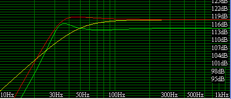

Silver Member Username: Joe1234Post Number: 992 Registered: May-09 | All subs at 750W RMS @ 1 ohm Yellow FiSSD 15" Sealed 2 cuft Red FiSSD 15" Ported 3 cuft @ 33Hz Red FiSSD 12" Ported 2 cuft @ 33Hz Obviously the 15" on ported kills any other configuration. And the port for the 15" will be smaller than the port on the 12" at the same tuning frequency. |
Bronze Member Username: HologramPost Number: 24 Registered: Mar-06 | Wow thank you so much for that! Now I have a much better understanding of what to expect. I will need to take some measurements to see if I could fit a 3.0 cuft box in my trunk. For what its worth my car is a 04 Chrysler Crossfire. |
