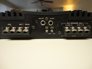

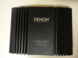

Bronze Member Username: WandaddyNaha, Okinawa Japan Post Number: 88 Registered: May-10 | ![]() |
