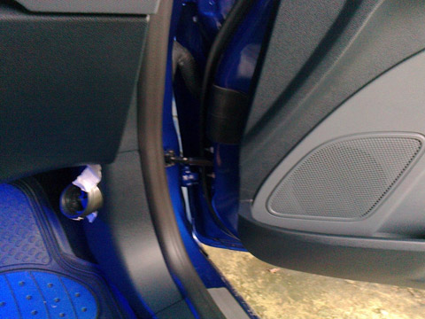

Bronze Member Username: ChofilenaIloilo, Iloilo Philippines Post Number: 26 Registered: Oct-11 | Made some research in the forum and that tweeter should be preferably located as near to the woofer as possible; located on top of the woofer where it is closer to the driver and the passenger side. Here are some pictures showing the spots where i would like to install my tweeter2011 Ford Fiesta hatch). Please tell me what you think. Thanks. ![]() ![]() ![]() 1st pic:kick panel, my first choice (-) :tweeter is not by the driver's side. 2nd pic: dash mount (-) tweeter faces toward the ceiling 3rd pic: door mount (-) steering wheel blocks tweeter toward passenger side 4th pic: current stock location |
Bronze Member Username: ChofilenaIloilo, Iloilo Philippines Post Number: 27 Registered: Oct-11 | Sorry, forgot to mention the components i have its a morel maximo. I know, it should be mounted on the door together with the woofer. But would it really make a lot of difference if the woofer is nearer to the passenger/driver than the tweeter and should the tweeter be always be higher than the woofer? I really like the looks on mounting it on the kick panels. I'm just hoping that someone would say its safe to install it there. Side by side with the woofer and again, only that the woofer is closer to the passenger/ driver than the tweeter. But tweeter is a bit higher than the woofer and angled towards the passenger/driver and the woofer is not. Maybe the tweeter being pointed towards the person could compensate for its located after the woofer. Any suggestion? Especially from the golden guys out there. Thanks. |

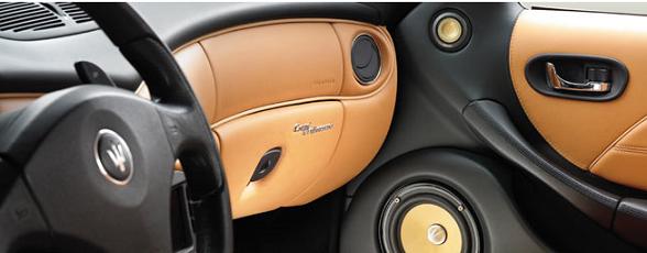

Silver Member Username: Joe1234Post Number: 672 Registered: May-09 | Check out this custom install from Focal's WS, notice the tweeter aiming straight at you: Perfect soundstaging not to high not too low. |
Bronze Member Username: ChofilenaIloilo, Iloilo Philippines Post Number: 30 Registered: Oct-11 | Hi Joe. That looks really nice and clean, seems it came stock with the car. Even the color of the speakers looks really nice with the upholstery. With my door, it would have been the same placement if only they interchange the tweeters and the side mirror control toggle. But what you think of the areas where i put the tweeter? Which do you think would give the best imaging? But of course i would still experiment on the tweeters, before drilling holes. Also, I'm a bit bias on the kick panels, because the tweeter looks nice there. And I'm still hesitant to use the flush mount because of the big hole its going to make. By the way i finally got everything and will start my installation on tuesday. Thanks for all the advice. |
Silver Member Username: Joe1234Post Number: 681 Registered: May-09 | The simplest rule is not to put them in a way that anyone's body on the front seats can obstruct sound (that would not be the case in the install on the pic) and not way to far from the midbass, but I have seen tweets being aimed at the windshield with interesting results. Really no rules, I made the point of tweeter location because people just pick a location and then get stuck with it since they already made holes, one other thing if your criteria is not to drill visible holes then probably an under-dash location could be your best bet. Regarding the install watch out for the chassis grounding on the amp, it's a common mistake with bad consequences, you could blow the EQ if your amp looses ground, fuse the EQ as instructed. All your grounding should be to metallic parts bolted to the chassis, very important to avoid pops, engine noise, amp overheating among other issues. Let me know if you have any concerns during the install. |

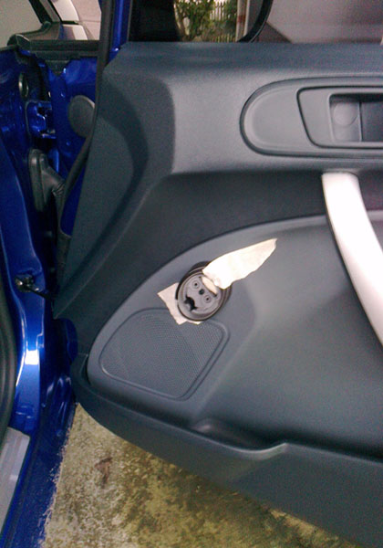

Bronze Member Username: ChofilenaIloilo, Iloilo Philippines Post Number: 31 Registered: Oct-11 | Thanks will try putting it in different location before mounting it permanently. Will update you and post pics when I'm done. Thanks again. |
Bronze Member Username: ChofilenaIloilo, Iloilo Philippines Post Number: 32 Registered: Oct-11 | Hi joe, I'm back and almost done with the installation. So far so good, sounds great only that there is still a slight hiss and whine on the front passenger side, which we could not find. I think we have done everything, checking the LOC, EQ and amp and its not coming from any of the units but still something is creating the noise. Hopefully will find it soon. Regarding the cache LOC this thing is powerful, did not even touch the amp's gain. The 4ch amp all set at zero gain, i wonder if thats good or not. Also, the bazooka BTA 6100 sub has doubled its bass, also at zero gain. EQ is easy to use and sends very clear sound. Tweeter location. Still trying to experiment but very confusing. I use the old IASCA disc for my reference. Tried the kick panels, doors, stock location, dash board and pillars . And so far the best location for my ears is on top of the dash and facing the windshield. I listen to the 7 drum beats and the 3 person saying left, center and right. But when i get to adjust the tweeter to make it as close as i could of the sound to their designated locations. But when i listen to it on the passenger side, it sounds far to their designated locations. What do you think i can still do? Also, the tweeter facing the windshield will this be right? Thanks. |
Silver Member Username: Joe1234Post Number: 715 Registered: May-09 | Hello Carlos, first I am really glad that the stock HU is providing the sound quality you were expecting, that's hard to achieve with a stock HU. If you have a friend or someone crazy about audio invite him in to share impressions regarding tweeter placement, Also listen the CD on good home audio or other car audio system. You also should know that the equipment itself and it's settings have an effect on soundstaging. Regarding the noise hopefully you will find the cause certainly the gains set to zero that let you listen at full power seem weird, try looking at the manuals for proper gain settings on the LOC, EQ and amp. If after a while you want me to look at the issues I would need to know how everything was connected and placed (signal/power/speakers) and details on the noise, like if its audible on your rear speaker, changes when the car is on/off, etc. |
Bronze Member Username: ChofilenaIloilo, Iloilo Philippines Post Number: 33 Registered: Oct-11 | So far i think followed the instructions on how to set the gain. First i set everything to minimum (head unit bass treble, LOC, EQ and amp). I increased the volume of the head unit before distortion. Increased the gain of the LOC before distortion and to match the volume of the EQ. Did not even really push the gain of the LOC to reach distortion because i was already satisfied with the loudness. Wiring: Head unit, i installed the front speaker wires to the LOC. -Power source for the LOC under the steering wheel ACC ignition switch . Output of the LOC to the main input of the EQ. -EQ power soure, same just tapped it on the LOC power source -from the LOC remote output i connected the remote turn on of the EQ , amp and amplfied sub LOC and EQ mounted under the dash of the passenger side. -Drilled a new hole by the right kick panel to ground them there. -4 ch amp location is at the baggage compartment mounted at the back of the seat -Power line on the driver side, RCA and remote on wires on the passenger side. (note: tried disconnecting the remote wire that runs with the RCA cable and wired it with the power line still get the same noise). Amplifier power supply. -Installed an in-line fuse by the battery and to the amp. Tapped the sub amp power source from there using 8mm power line. -ground source, on the seats bolt. EQ to Amp using RCA cables Amp to speakers, Front, used new wires for the component speakers - tweeters on the dash, passive crossover inside the kick panels Rear, tapped new wires to the old spreaker wires to run the coaxcials |
Silver Member Username: Joe1234Post Number: 718 Registered: May-09 | Ok Carlos, I will assume that you are using 3 RCA sets from the EQ to the back. Also is important to know if the whine stops when the car is off. Some defective electronic devices create their own noise, also, under when in wrong supply voltage, the hiss can present itself with the car off. There is another thing, the +12 supply to the LOC and EQ should be straight from the battery and *fused* (page 4 on the cache manual also suggest this) the ignition switched +12 to the remote in on the LOC and the rest is OK, this is done precisely to avoid noise issues. To test if the incoming signals to the amp are not clean just unplug the RCAs at the amp and turn on the car if you cease to hear the noise then that is the case. |

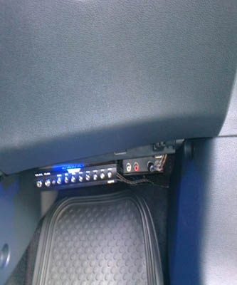

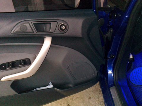

Bronze Member Username: ChofilenaIloilo, Iloilo Philippines Post Number: 34 Registered: Oct-11 | The hiss and whine is there when the car is on. But this morning the sound went away, could it be a faulty RCA plug? And yes, I'm using 3 RCA sets from the EQ to the back. With the tweeter placement, we decided to put it on the dash facing half way in between the driver's ear and the ceiling. Here are pics of the installation.![]() ![]() ![]() |
Silver Member Username: Joe1234Post Number: 727 Registered: May-09 | Your install looks nice and clean, so great it's done. Bad news you have no sound, no RCAs will fail like that. First check that all devices have power (lights on). If you hear nothing not even the bass then the EQ is not receiving signal from the LOC try connecting something on the AUX input on the LOC and switching to it. If you still hear the bass tube but not the speakers the fuse on the amp could be blown. Don't know if you performed the mod I suggested in my previous post. |
Bronze Member Username: ChofilenaIloilo, Iloilo Philippines Post Number: 35 Registered: Oct-11 | Its all done now, sounds great. Finally the whine and the hiss went away and the truth is, I really don't know what i did. But its all working perfectly now. I'm just hoping that nothing will come out anymore. Joe. thank you, thank you for all the help. Tweeters are still temporarily mounted and still trying to find the sweet spot. |
Silver Member Username: Joe1234Post Number: 729 Registered: May-09 | Ok Carlos, I am really glad for you, not everyone ends up getting the results they want out of an install so you are one of the lucky ones. Since you don't have much insight on the problems you experienced those might show up later but I guess that are not serious. And it usually takes a while to get the best out of your audio, I am sure you will nail down the perfect location for the tweets. Best of luck and if you ever want to upgrade or have any questions let me know. |
