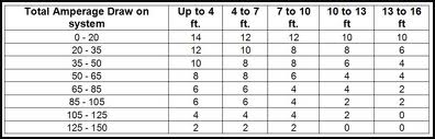

Silver Member Username: Joe1234Post Number: 956 Registered: May-09 | One can just set a target current and choose any wires that can handle that current, that unless are noname stuff proboably overrated, if you are using CCA though, you better aim for higher spec say 10% above you requirements and fuse accordingly just to be safe. Other than that I wouldn't worry to much. And WOW if it's 375A you could wire a 4.6K amp on that cable or probably more on 14.4V or above! |
Bronze Member Username: Dcollister440Post Number: 71 Registered: Jun-11 | yeah man...just bought some off a guy @CACO... he had a 25' run of black KNU OFC for 85 shipped...stoked on it!!! plus got some battery terminals for 10 shipped from another guy, pos and neg....xscorpion they have 3 screws so I'll have enough to run stuff with. I know this is way ahead of the game, but if I wanted to put an extra battery or two in the trunk how would I know what to get, as far as matching it to my system....like would I look at the amphours on the battery and match it to the ampdraw from my amps? |

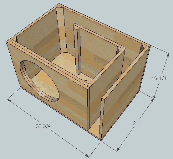

Bronze Member Username: Dcollister440Post Number: 86 Registered: Jun-11 | bro, epic fail....thank you but super epic fail...redid measurements today, because I knewI missed something....the depth can probably only be 16", tops 18 because of the lip on the trunk, the width can go as big as 33" but the height can only be 18....epic epic fail....thank you for doing this though, think you could redo it with these dims...I'm so sorry bro...I know you spend your time with this stuff....so 18D 18H and 33W and what would be the difference tuning it to 30hz instead of 32 hz? what would that look like? and if you can try and keep it double baffled...lemme know brother...thanks again man you're awesome...are you on any other forums? and if so whats your username? |
Gold Member Username: Joe1234Post Number: 1280 Registered: May-09 | Well if you don't have the sub yet, think about 2 12" those will sound much better if you can get them in proper volume, 30Hz is a really low tuning, good for young jeezy stuff and the likes, to play a wider range of music a little higher tuning is used. The BL 15" willl work rather tight in the new dims so think about this and let me know. |
Gold Member Username: Joe1234Post Number: 1283 Registered: May-09 | Ok so check this plot, SPL Vs frequency BEFORE cabin effects at rated power. Green Fi BL15" 3 cuft@ 30Hz Blue Fi BL15" 4 cuft@ 30Hz Red Fi Q15" 3 cuft@ 30Hz White Fi BL15" 3 cuft@ 40Hz From the plots you can see that the BL is more of a SPL driver that gives much more output high tuned, the Q works better on low tuning. The BL can work at 3 cuft@30Hz but is not really a good configuration for it. |
Bronze Member Username: Dcollister440Post Number: 87 Registered: Jun-11 | ok so I'm kinda effed then man...I got a box built, it ended up being 3.7^cubes net @32hz, but it was way too deep. I can only go like 18" deep 34"wide and 18"height.........My friend is building another box, going to be single baffle and tune it to like 33 hz I guess....I shoulda got a fricking Q man,....kinda kicking myself for it, but I'll roll with this bl for a while then get something new in about 6 months....haha |
Bronze Member Username: Dcollister440Post Number: 88 Registered: Jun-11 | are you on any other forums joe? if so let me know, this one is dead and I'd like to stay in contact with you |
Gold Member Username: Joe1234Post Number: 1368 Registered: May-09 | Those dims should work: Enclosure Specifications: Fb = 33.011 Hz Vb = 3.754 ft^3 External Height = 18 in External Width = 34 in External Depth = 18 in Port Width = 3 1/2 in Cut Sheet List: * All Dimensions in Inches. * Wood Thickness is 3/4 for all Parts. External Enclosure Parts: Front & Back = 34 x 18 Left & Right Sides = 16 1/2 x 16 1/2 Top & Bottom = 34 x 16 1/2 L Port Internal Assembly Parts: Front to Back = 13 x 16 1/2 Extension = 12 x 16 1/2 Place some front to back crossbracing if going for a single layer baffle. Yes the Q likes the low end better and can live in 3 cubes but looking at the above your still ok on 3.7. Should hit way harder than the 13.5 JL. I still like it here don't think is going down just yet, if I were to move on I think would go to DIYMA as is SQ oriented.. I guess I will setup something there... |
