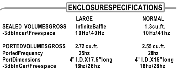

Bronze Member Username: MkeetsPost Number: 20 Registered: Oct-11 | Sorry a bit off topic but on another thread you said IDMAX's work better in larger enclosures than an Fi Q how large of an enclosure should an IDMAX go into? And better sealed or ported tuned to what? |
Silver Member Username: Joe1234Post Number: 623 Registered: May-09 | This is straight from their technical sheet: Exact model is iDMAX 12D4 V.3 I guess the "NORMAL" will suffice for most people. |
