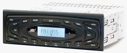

New member Username: EclipseguyPost Number: 1 Registered: Sep-11 | hello my name is sean and im new here. I was wiring some new speakers in to my truck (1986 ford ranger super) and i had the head unit on (road master vcrd300m) so i could see which wire was the power and which one was the ground. well i accidentally dropped a wire and it hit the ground and now there is no sound coming out of the head unit except threw the sub woofers . dose any one have an idea what is wrong or did i blow my head unit. this is my head unit ![]() |
Silver Member Username: Joe1234Post Number: 510 Registered: May-09 | The internal amplifier that powers your speakers is most likely done but you have RCA pre-outs so with a cheap amp you can recover sound. I don't usually recommend something this cheap but I guess that if you only want to recover what you had, it makes sense, a repair would cost more: http://www.ebay.com/itm/MA170-2-channel-Hi-Fi-Stereo-Amplifier-F-Car-Boat-Radio- /200598658277?pt=Car_Amplifiers&hash=item2eb49c9ce5 The manual for your HU: http://www.vr-3.com/downloads/VRCD300M_English_WEB_Manual.pdf |
