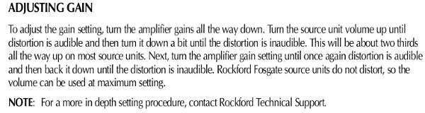

Straight from the manual of your bd1001:
For 2 amps you need to do this separately disconnecting the RCAs of the one you are not working with, when you are done with both connect all RCAs make a note the position of both gains.
If there's too much bass lower gain on the bass amp, same thing goes for mid-higs, if too loud lower the the gain on the speakers amp until you get a good balance.

http://www.glasswolf.net/papers/dmmgain.html
http://www.glasswolf.net/papers/whatisgain.html
