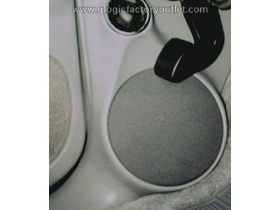

Silver Member Username: Joe1234Post Number: 319 Registered: May-09 | No Jack, when you don't have space for speakers in a car you usually install them in kick panels: That could fit the MBquarts I suggested earlier. When you can't find ready made kick panels then a fiberglassing job is required. Apparently you can install 6"x8" speakers instead of 5"x7" that would help midbass so you should consider that option as well, I think some shallow mounted 6"x9" could be adapted there That should be your first choice. Talk to an installer to check options. The box you are looking at can't fit 7" drivers, midbass drivers should be mounted separately on each side of the car (left, right) not together like subs. |
