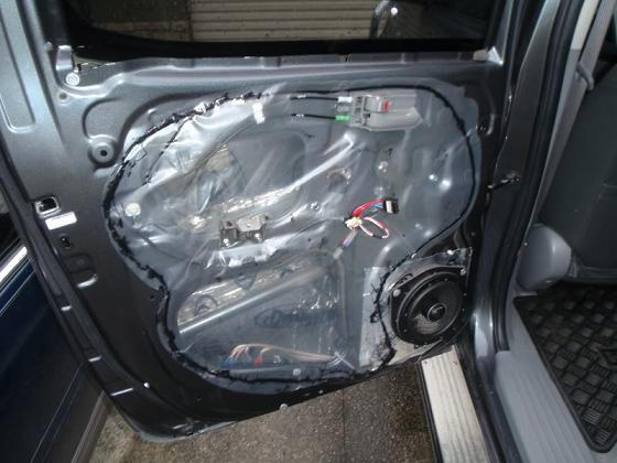

My system at current is
Kicker qs6.5 in all 4 doors @75wrms ea.

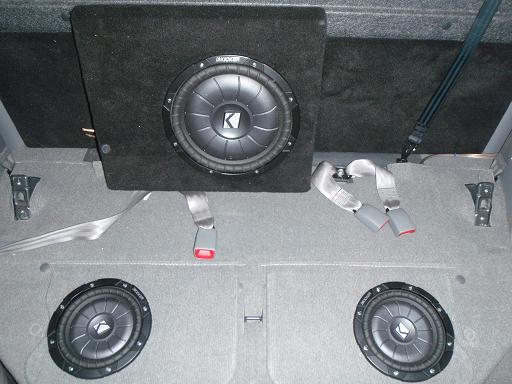

2x Kicker cvt8.4 under rear seat @210wrms ea.
1x kicker cvt12.2 behind rear seat @400wrms
I plane on keeping the 8" under the rear seats as there tuned for 60-125hz and my doors are 125hz up
And my 12 is out the door so im looking for something to fill 0-60hz

And my Amps sit either side of the 12"
i have a kicker zx700.5 on right and zx400.1 on left
And of corse the back seat sits on top
The 12" in box with amps either side is a tight fit thats why im looking at bandpass in bed and ported into cab

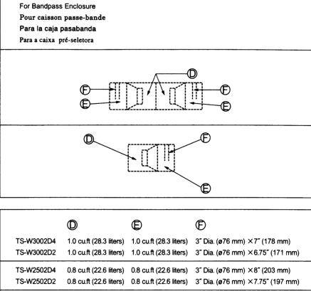

john there are incredibly powerful subs that work on very small boxes:
http://www.sonicelectronix.com/item_16665_Pioneer-TS-W3002D4.html
These need 1-1.3 cuft ported have high sensitivity of 90db and go right down to 20Hz, 1000W RMS each.
And may be called SQ against L7s
If you only want the bottom end adjust your LPF accordingly.
And yes they are mainstream.

Ok so regarding the sub I suggested in my previous post check the frequency response curves for sealed, ported and bandpass for the 10" and the12" (the 10" fits on a 0.35 to 0.70 cuft box sealed):
http://a248.e.akamai.net/pix.crutchfield.com/Manuals/130/130W3002D4.PDF
Bandpass will not reach 70Hz at usable levels and SQ will be basically junk.

As for making the 12" box wider thats impossible as the amps are on both sides and dont fit anywhere else
As for fitting and 18" under seat that would require some major mods to car
If you look at pic of 8's the boxes are very small and steal there appart of the seat + in the middle (where no box is)is the tailshaft or driveshaft is so no space there either
So under the seat is out of the question the best i can do is the pioneer 10" slimline with a spacer plate in the same spot as 8"
The bass i get from the 8" im happy with i just want that low/deep bass that cant be do by any slimline subs or small/shallow boxes
