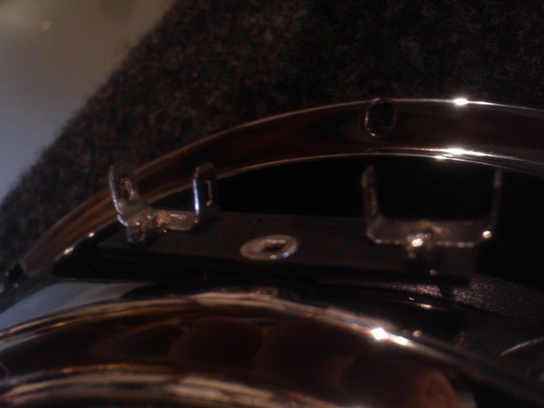

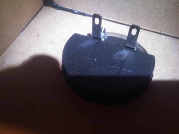

Bronze Member Username: Magnus28Petawawa, ON Canada Post Number: 15 Registered: Aug-11 | as per title, what connectors do I need to wire these? to this sub enclosure Note: It appears that my subs have 4 terminals each, even though it is only a single coil.... also the sub terminals are completely different size (height and width) then the ones on the box Thanks in advance! |
Gold Member Username: KaerfplSpencerport, NY USA Post Number: 1230 Registered: Jun-06 | You can do one of two things. You could either purchase some Female Quick Disconnects or simply solder the wire onto it. http://www.sonicelectronix.com/item_2931_Female-Quick-Disconnect-BLUE-INSULATED- Connectors-.250-16-14G-100-Pack.html |
Silver Member Username: AlonzoubPost Number: 248 Registered: Apr-10 | What I do is solder to the terminal cup in the box and use female quick disconnects for the speaker. If you don't have a soldering iron its a pretty good investment if you are handy with electronic repair... you can pick up a 40 watt soldering iron for $10 at radioshack and some 40/60 solder for like $2. If you don't want to solder then you going to need to look for the correct size disconnects for both sides, sometimes that can be a pain. EDIT: O yeah and just consider each one of those U shaped terminals on the sub as a single terminal. Im not sure what the idea behind that terminal shape is but... yeah its one solid conductor so its just 1 terminal. |
Bronze Member Username: Magnus28Petawawa, ON Canada Post Number: 16 Registered: Aug-11 | thx for the advise ;-) not good with a saudering iron - not gonna lie. any suggestions on what size female quick disconnects I need to get? I know 2 of them are different. |
Gold Member Username: KaerfplSpencerport, NY USA Post Number: 1233 Registered: Jun-06 | Wouldn't be able to tell you by just looking at pictures. The "Female" connectors are only like $3 for 15-20. Just purchase one that is slightly larger than you think you will need, and crimp them onto the "Male" ends to assure they will not disconnect. |
Bronze Member Username: Magnus28Petawawa, ON Canada Post Number: 17 Registered: Aug-11 | thx joe.. appreciate the advise |
