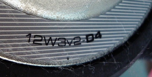

If you are completely sure that you have the12W3v2-D4 subwoofer then straight from your.pdf it says Power Handling: 300W (continuous) that's RMS power it also should have 4 terminals 2 on one side 2 on the opposite side.
To better take advantage of the amplifier this sub should be wired in parallel (as in the picture above), the resulting impedance is 2 ohm so the amp connected to it should allow for a 2 ohm load.

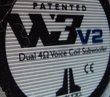

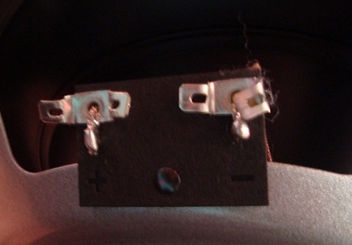

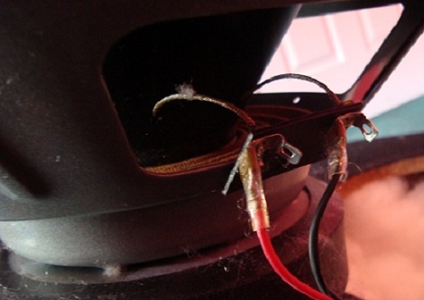

Hey. After hearing what everyone had to say I went and took my sub out of the box and took a few pics... it looks to me like it is wired in a series. So I guess the sub has never been used to its full potential....funny, because it used to knock anyways! I hope the problem isnt the sub The way it is wired now is the way I got the sub...it was given to me by my boyfriends friend at work.
So should I try to undo the positive wire and put it on the othet set of terminals?
And also, how do i safely detach that connection without breaking? does it look soldered?

Your Subwoofer should not be the cause of the problem. Like everyone stated above, it's most likely that Sony Amplifier.
What I would do, is get a pair of wire cutters and cut off all the copper wire on the terminals, then purchase some Female Quick Connectors and new Speaker wire and redo your connections to the Amplifier.

The sub is being run on a single coil at 4 ohm (not series), effectively reducing its power handling by 50% or 150W RMS.
Also the soldering job on the vacant terminals seems awful and the terminals are obviously bent. I would say that the condition of that vacant coil is to say the least questionable and should be checked before attempting to use it.
That does not necessarily mean that the amplifier failed because of this, its more like it failed on its own. It would be best to replace the amp instead of having it repaired.

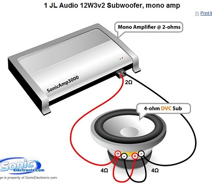

Also, I found this wiring guide for my sub. So basically, I have to connect the positive on 1 terminal to the positive of the other terminal and then have that connect to the connector on the speaker box...and the same with the 2 negatives...right?

The vacant coil should be checked for integrity maybe the driver wires should be resoldered, there is a chance that the coil is open inside in which case the sub can only be used with a single coil.
The diagram is correct but deceiving since apparently you have four connections on each side of your sub, opposite sides positive and that to the positive on the amp, opposite sides negative and that to the negative on the amp is the correct way to wire in parallel.

Hey I have been looking at diagrams for wiring the 1 dvc sub parallel..and the way its set up is different than mine. [See the pic I composed below]
They have it so both the positives are across from eachother and likewise for the negatives.
Is it bad that mine are diagonal from eachother?

Victoria, you are looking at the same diagram is just that electrical diagrams do not account for physical location of things, the only thing that you need to do is to tie both sub positives to the positive on the amp and to to tie both sub negatives to the negative on the amp.
The reason you see 4 terminals on each side is that 2 are positive and 2 are negative but having 2 of each makes it easy to continue the wiring to the opposite side coil.
I was wondering if someone could lend you a "multimeter" its a $10-$20 device that could help you a lot if you want to do this on your own, for example checking the vacant coil. It is not strictly necessary but its makes checking anything electrical easy.

That speaker looks like it was tampered with before anyways.

But I am definitely giving up on the jl audio. I even tried to hook up that other coil that was never hooked up, and that didnt work at all. Maybe thats why it was never hooked up in the first place.

The other day we really made sure the connection was good on the inside of the speaker box terminal. For the past day, everything worked fine and it did not cut out at all. Now today I went to the store and the sub keeps cutting in and out, in and out. The blue light on the amp stays lit at all times and it does not go into protect mode. Right now I am going to bring the sub in the house and put all new wires from the sub to the terminal, and then from the terminal to the amp.
If it still cuts out after I do this, could you tell me what other problems it could be? could it be the speaker box terminal? Or do I have more serious problems. Please take into consideration that I have no cool little gadgets like voltage meters and what not.
also, when the sub is on, it is definitely fully functioning...it works and sounds completely fine and normal....just thought I would add that tidbit in.

the box I have sucks and its old. The spot where the terminal is located is all messed up from screwing and unscrewing over and over.
If I were to get a box, does it have to be the EXACT recommended dimensions that the manual says? Or can it be pretty close??

ok I just completely rewired the sub..inlcuding wires from sub to box and box to amp.
It worked great for about 20-25 minutes, then it started cutting in and out again. Again, the amp stays on w/ a blue light at all times...the gain is set to half, the frequency is on about 80 hz, and the bass boost is set to a little less than half way up. Everything on the deck is set to 0, except the treble.
I have the little connectors covered in plactic connecting the speaker wire to the inside of the terminal on the box...but I dont have crimpers so we just used needle nose pliers to try to squish them...could this be why it keeps cutting in and out? We also just tried using electrical tape over the wire directly attached to the connection...but it seemed to cut in and out then also.
oh and about 2 days ago we ran a speaker wire from the sub directly to the amp, bypassing the speaker box terminal and it worked fine....We only kept it hooked up like that for a few moments...since we had the sub out of the box and everything.
What else should I check? I really dont want to ruin anything and I am trying to be extra careful.. I am also kind of aggravated right now that it wont stay working

For now I would only run a good wire from the amp straight to the sub bypassing the box terminals and use it like that.

ok I actually just screwed the terminal over the wire...I only used 3 screws instead of 4, just so it doesnt squish the wire too much.
I am going to go for a ride right now and see if the sub stays on.

However, from what I did read, I had a similar problem myself a few years back. Turns out that the screw terminal that came with the prefab enclosure I purchased off eBay was actually becoming loose and "unscrewing" itself little by little with each hitting note until the speaker wire eventually would fall out.
Im not sure if that situation may apply for you or not, but if it does, I would suggest switching to a spring loaded terminals like the ones in the link below:
http://www.chokes.com/rgt4050.htm
Also, simply crimping speaker wire onto a speaker terminal is only a band-aid. Eventually, it will come undone and loosen. What you want to do is either solder the speaker wire to the terminal or, purchase some Female Quick Disconnect Connectors to assure that the wire will not loosen over time.

ok..so last night after we ran a wire straight from the sub to the amp, I almost had a nervous breakdown, because the sub would not come on at all. We disconnected it completely and just gave up...it was getting dark.
so this morning my boyfriend redid everything and just ran it again through the terminal on the box...and it is on for now...I told him not to turn it up to loud because I am afraid to really push it at this point..I dont want anything to happen to the amplifier.
what the hell is going on????? ahhhhhhhhhhhh i could scream.
I am really about to go get a multi meter on wednesday when my boyfriend gets paid to simplify my life...but I have no idea of how to use it. Would a multi meter be able to tell me if it is the RCA's before I go undoing everything? The rca's are old....from my previous set up. When we initially set up the new stuff, I removed the head unit and checked the rca's. They were so tight on the back of the head unit, that I did not bother to take them off and put them back on in fear that I would break the assembly. I would say they are atleast 2 years old.
Could this problem possibly be a faulty subwoofer? or is that absolutely not the issue? and again, would a multi meter be able to determine that?

If you were to keep that terminal block on your sub box I would get a $5 soldering iron (along with some solder) to have those connections done properly since they are obviously loose, Id say that there is a 70% chance that the issue is there.

So do you think I should forget about the multimeter and just get a brand new box from the sonic electronics site? Since yesterday morning, the sub has been on and has not cut out at all.
The only reason I am thinking to just get a new box instead of just getting a new terminal is because as I mentioned before, we have really messed it up in the area where you screw on the terminal...from taking it off and putting it on too much. Unless I get a terminal that requires a bigger hole...then I would have to cut out the part that is stripped and start fresh.
Whichever option I choose, I will definitely take your advise on the soldering iron and just solder that foolish wire directly onto the terminal.

Ok, I would use the current box with soldered terminals if it all goes well then you are done. If the problem persists a few other simple things can be checked, if that also fails then a multimeter could help at that point.
You can buy a box if you want but that will not fix the issue, most likely you will need to do a soldering job to it as well. If you want one buy a sealed one 1.2-1.4 cubic feet (internal airspace) watching that it fits in your car!
