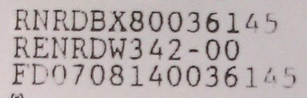

Username: Mrliam
Registered: Sep-10
Just took the battery off my car for charging, now require a code for the radio
2008 Clio
These are the codes that are printed on the side of the unit. Would be great if anyone can help?
Username: Hay88
PortsmouthUk
Post Number: 1952
Registered: Mar-10
Mrliam
your code 5851 you must hold at end to store code.
IF YOU DONT HAVE KEY THEN PUSH THUMBWHEEL IN AND SOME HAVE {A} KEY
Turn on the radio and the display will show 'CODE'
Use the steering controls for code entry.
Press the [ ] button then rotate the thumb wheel for the correct first digit
Press the [ ] button then rotate the thumb wheel for the correct second digit
Press the [ ] button then rotate the thumb wheel for the correct third digit
Press the [ ] button then rotate the thumb wheel for the correct fourth digit
If the correct code is now shown on screen,
press and hold the [ ] button for up to 10 seconds to store the code
