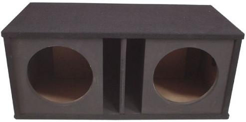

Okay i found someone to custom make me a Ported box for these subs and these are the specs he recomended/ And i agreed. Before i give him the "Go" to start working on it i want to get other peoples opinions/sugestions and or comments.
*Chambers: 2 Each subwoofer with its own chamber
*Cu Ft per chamber: 2 cu ft
*Tuned from anywhere from 30Hz-35Hz (Please give a suggestion...Im thinking of 32Hz)
*3/4" MDF
Now i am stuck on which design i want to go with...
The 2 ports/Vent side by side in the middle such as...
http://yfrog.com/neportedbox2j
or
The ports/vents on the sides of the subwoofers such as...
http://yfrog.com/5eportedboxj
Your advice/comments well apreciated.
Thank you

id pick each subwoofer with its own chamber & port like in that 1st pic :
3\4" mdf is fine
32-33hz is good
between 2.2.25 after sub port displacement is good too ...
