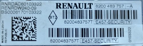

Hello,
Can someone help me for the code, The Renault code details are:

Raulo
your code 3970

3970 is the correct code for those Serial Numbers.

Code Entry as Follows:
Switch Radio On - Display Shows
" CODE "
Then " 0000 " with the 1st digit flashing
Rotate " Thumbwheel " For Correct Digit
Press " " On The Stalk Control To Enter
If the correct code number is now shown
Press And hold }" " Until A Beep Is Heard
