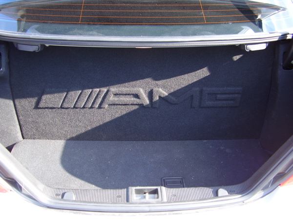

Gold Member Username: JakeyplaysbassSt. Louis, MO / ASU Post Number: 3799 Registered: Jul-05 | Yeah I was thinking a decent sized slot port with the 2510 at around 1.5-1.6cuft. Right now if I take ~3" off the length of my current 2.54cuft box I will be able to fit my hockey bag in the trunk. Heres where I'm at now... All I need is a little space... It might be a tight fit but anything is better than having to smell my gear in the back seat, Haha. |
Silver Member Username: Sleste8Shelbyville, MI United States Post Number: 163 Registered: Mar-10 | lol, yeah hockey gear gets pretty bad. but the worse it smells, it seems like the better you play, haha that looks like it's a pretty nice box tho, |
