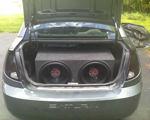

ok so currently i have 2 15in american bass xos running in 1 ohm of an american bass sq800x2.....okk but its time to take things serious i bought that jus to have some bumps. the first steps im taking is all new electrical...where can i find a strong enough alt? im ordering all new 0/1 gauge wiring tomorrow after work but i need to find a new alt and battery or 2....ive been thinking about what subs and amp to get but i think im gonna go with 2 15in BLs dual 2 ohm running of a Sundown Audio SAZ-2000D....and i dont know if it matters but my headunit is a Jensen VM9312....thanks to all who help im excited to start putting together a real system!!! i wish i didnt have to work in 4 hours

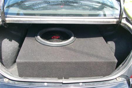

Idk how much bigger your trunk would be than mine. Just to give you an example. This is my dd1515 in a 4.0cuft box in my dodge neon. I couldnt get anything bigger in there if i tried!lol

Carl, a BTL18 requires a ported box (no sealed) and it will need about 8 cubic feet. Do you have that much room? 2Kw is a good power soource for a BTL 18. You could even move up to the SAZ-3500D and be happy.
As for the batteries, please see the links (to my site) that I gave ya above. They explain sizing batteries and how to isolate audio batteries from the starter battery properly.
Two of the batteries I linked (the platinum diehard deep cycles which are the same battery as some big name audio batteries, with a different label) with bus bars will do the job on an isolator. Then you just run the 1/0 wire from alternator to audio batteries, and wire the amps right to the battery posts.
the BTL18 would need twice the box of the above pictured 15, for reference.

pos prefab seaed box lol....took some measurements 44w x 27l x 23h not exact but rough measurements
