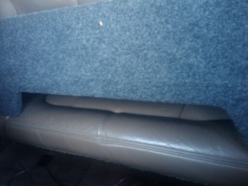

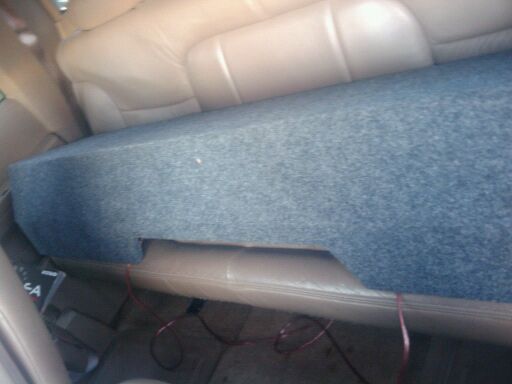

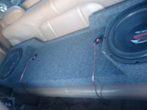

can you take a picture of the box in the truck and post it here or on photobucket? That would help visualize this better.
What size subs are in the truck now?
Username: Chevy4u
Dallas, Tessas United States
Registered: May-10
Sure; here ya go. And the Subs I have currently are 12's
Username: Glasswolf
Post Number: 13535
Registered: Dec-03
OK, without knowing the volume of the box (which you could find using packing peanuts if you're ambitious) I'm going to say that box probalby isn't really large enough, or reinforced to handle BTLs, but you could run Fi SSD 12" subs in the existing (nice, by the way) box, and just switch amps. I'd drive them with a Sundown SAZ-2000D amp (2Kw @ 1 ohm) and get each sub in dual 4 ohm coil version, so you can present a 1 ohm load to the amp and feed each sub 1Kw.
