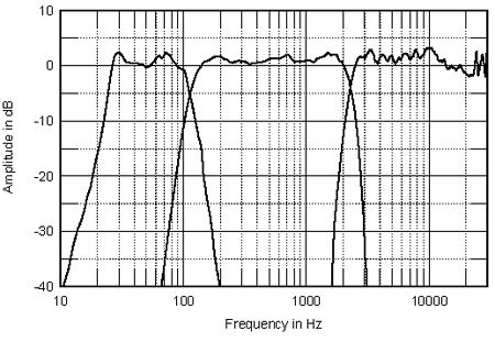

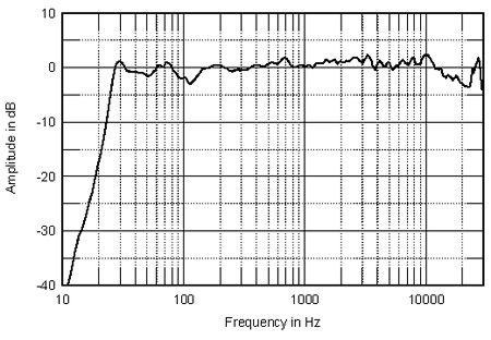

I thought I would post a couple charts to help explain what Glass is trying to say. The top chart shows the frequency responses of a subwoofer, a mid-bass driver and a high frequency tweeter. Note the "skirting", or overlaps in frequency output, where each driver meets the next at it's rolloff. The bottom chart shows the "summed" output response taking into account the fact that whenever two drivers overlap each other in frequency, the result will be an increase in amplitude in that range. This is why the dips that were present at max amplitude where the drivers meet in the top chart, are flat on the bottom chart. This is an extremely important theory to learn and if you can rap your head around what is happening here it will help you greatly in your future audio adventures.
