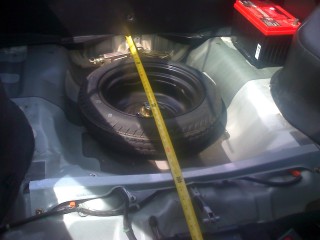

Gold Member Username: DelsolePost Number: 1494 Registered: Feb-05 | ![]() ![]() |

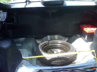

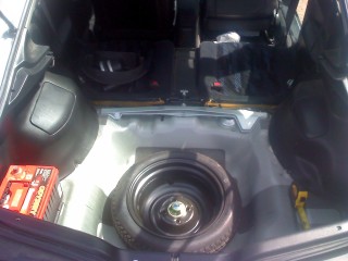

Gold Member Username: DelsolePost Number: 1495 Registered: Feb-05 | ![]() ![]() ![]() ![]() |
Gold Member Username: DelsolePost Number: 1496 Registered: Feb-05 | My length is about 40 inches the depth is about 30 and my height is 16 inches. |
Gold Member Username: DelsolePost Number: 1497 Registered: Feb-05 | I would have kept everything in the other post but it seemed to be getting a bit cluttered. |

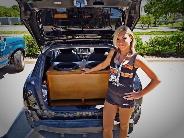

Gold Member Username: DelsolePost Number: 1499 Registered: Feb-05 | ![]() I really like the way this box looks. I don't have the height to make that but i think i can make up for it in the length. Does anyone know what this box is tuned to? And perhaps How many cubic feet is is? |
